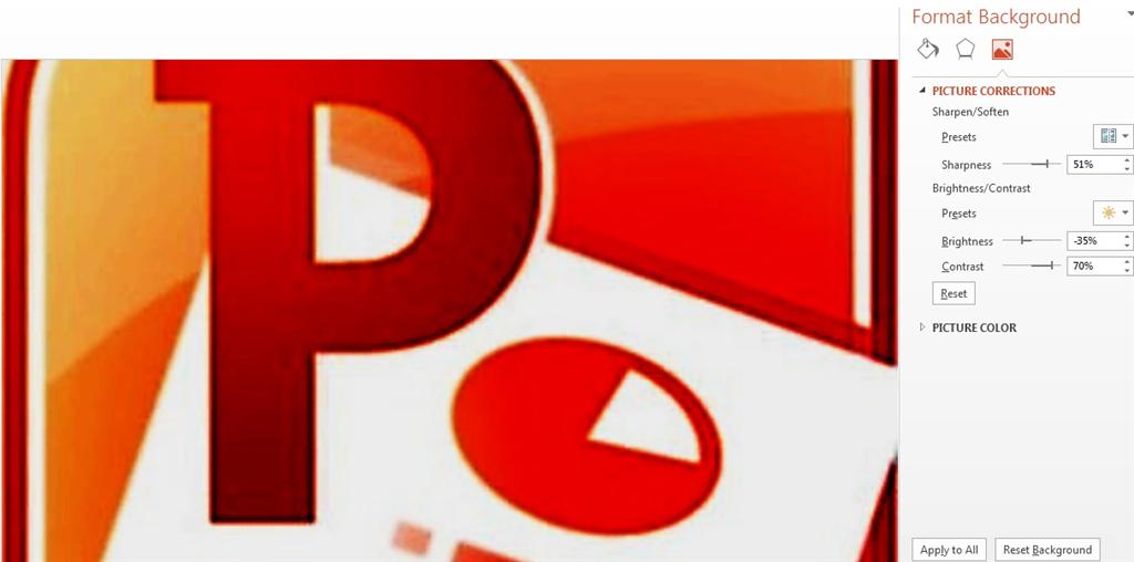

    Hello John,
    Thank you for reporting that this issue occurs in PowerPoint 2013 64 bit. However, I'm not able to repro this issue in PowerPoint 2013 32 bit.
    You may check the screen shot below:
    Thank you.
