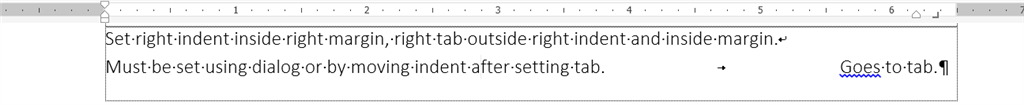

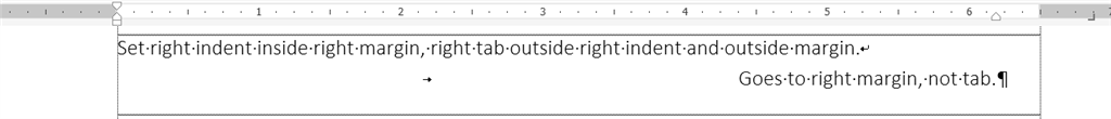

In Word 2016 (or in Word 2013 with the most recent updates) for Windows, you can set a tab stop to the right of a right indent, but NOT to the right of the right margin. This is by design. See screen shot below.
Also, you must use the Tab dialog box; you can't add such a tab stop by double-clicking the horizontal ruler.
Older file formats still support the older behavior, which is to be expected.

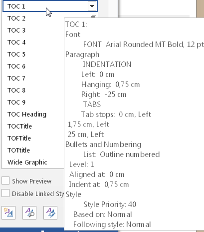

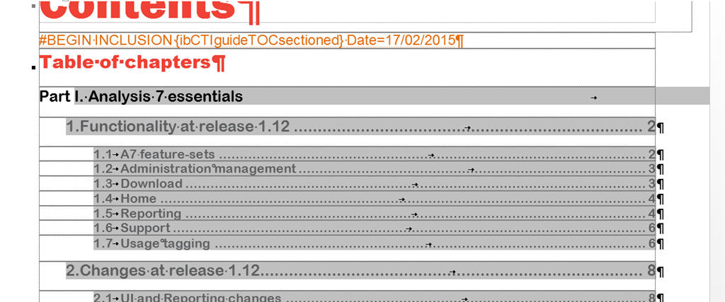

    I had a similar requirement to use the tab stop beyond right margin; it was a useful way of 'not' printing pagenumbers for certain TOC levels for instance.
    I found a workaround that fixed it for me. Simply set the style for TOC 1 (in my case) to have a negative right margin; this extends the line lenght for that style and you can set the tab in (or in my case beyond) the increased right margin.
    This allows me to show the table of contents without a page number for the TOC 1 line as below:

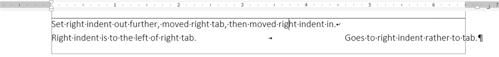

    These are in Word 2013 native mode. A right tab can be to the right of the right margin, but only within the right indent. If a right tab is needed outside the right indent, both must be inside the right margin.
