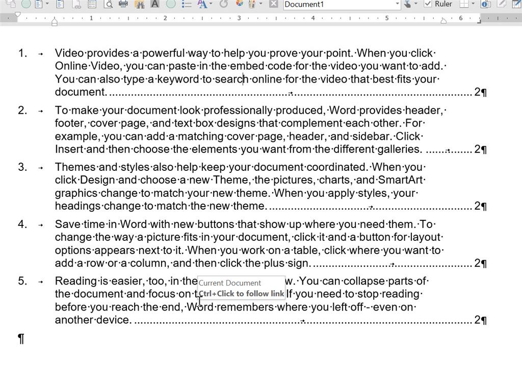

In Word 2016 (or in Word 2013 with the most recent updates) for Windows, you can set a tab stop to the right of a right indent, but NOT to the right of the right margin. This is by design. See screen shot below.
Also, you must use the Tab dialog box; you can't add such a tab stop by double-clicking the horizontal ruler.

    Assuming that Office 2013 is fully updated, you can add a tab stop to the right of a right indent, but not outside the page margin. The limitation is that you can't click the ruler to set such a tab stop; you must use the Tabs dialog box—or, since you are using styles, do it via Format | Tabs in the Modify Style dialog box.
    If you save your document to *.doc format, tab stops outside the margin will be recognized.

    Note that you have to add the tab stop to the style via the Tabs dialog box (in the Modify Style dialog box, click Format, Tabs). You can't just click the ruler to add a tab stop to the right of a right indent.
    Also, unlike older versions of Word, you can no longer set tab stops outside the right margin. This remains true even after you have applied the hotfix.
