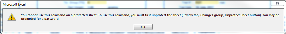

    2017-07-24T09:25:17+00:00
    Hi Hans,
    I'm using a code based on the above, exactly this one:
    Private Sub Workbook_Open()
        With Worksheets("Sheet1")
            .Protect Password:="psw", userinterfaceonly:=True
            .EnableOutlining = True
            .EnableAutoFilter = True
            If .FilterMode Then
               .ShowAllData
            End If
        End With
    End Sub
    It works perfectly, but I have a problem when I copy the "Sheet1". It creates a "Sheet1 (2)" and it works correctly, but when I go back to "Sheet1" the following message appears:
    The message is back everytime I move to "Sheet1" from another sheet. It disappears definitively if I press "OK" and then I press the arrows on the keyboard and move to any other cell.
    Which could be the root-casue and the solution?
    I read all other answers in this thread, but seems could not find a similar problem.
    Thanks in advance!
  4. HansV 462.7K Reputation points MVP Volunteer Moderator
    2017-07-24T20:09:26+00:00
    Right-click the sheet tab of Sheet1 and select 'View Code' from the context menu. This activates the worksheet module. Does it contain any code?
