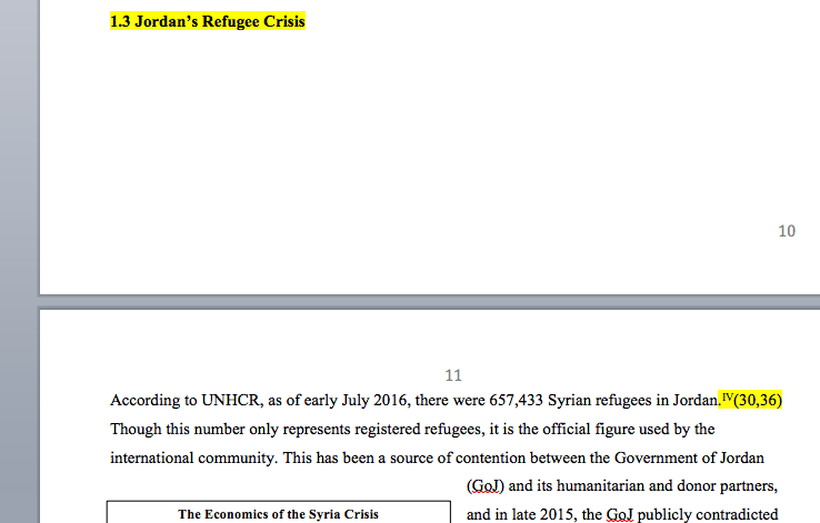

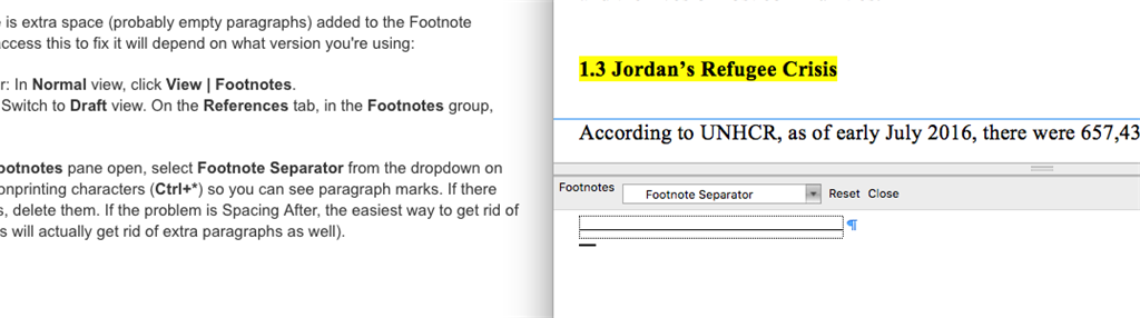

    2016-07-26T15:56:24+00:00
    Hi yes, nothing seems to happen. When I open the footnotes window, the page break doesn't have any spaces around it (see picture). I've tried all of these suggestions and nothing is working. I think it might have something to do with a combination of the footnotes and the anchor for the text box on the page below? I have no idea.
    but this is what it looks like in print view:
  2. Jay Freedman 208.3K Reputation points Volunteer Moderator
    2016-07-26T21:22:28+00:00
    What you're showing here isn't related to the footnote. It's caused by having the text box anchored to the first paragraph after the heading.
    In Word, a floating object (text box, graphic, etc.) is required to be on the same page as its anchor point (see "Major Concept #2" in http://wordfaqs.mvps.org/AnchorToHeader.htm). The text box won't fit in the space at the bottom of page 10, so the text box and the paragraph are forced to page 11.
    There are two solutions to this problem:
    • Move the anchor of the text box to the second paragraph after the heading. As much of the first paragraph as will fit in the space will move back to page 10.
    • Right-click in the heading paragraph, click Paragraph, go to the Line and Page Breaks tab of the dialog, and check the box for "Keep with next". That will force the heading to accompany the next paragraph to page 11, but will leave the space at the bottom of page 10.
