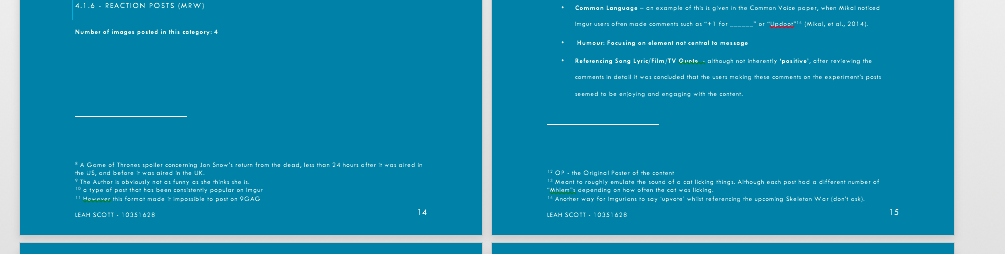

I have a long document with many footnotes. On some pages, a large space, sometimes only enough for one double-spaced line, sometimes enough for two, appears above the footnote separator. How can I get rid of this space? I've turned widow-orphan control off, so it shouldn't be related to that. I've looked at the separator under "show notes" in draft view, and it doesn't appear to have any extra spaces associated with it. This actually happens with all of my Word documents.
