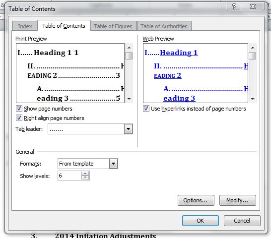

    Hi. I have been working on a document that requires a custom style, multilevel list, and TOC.  I was following the recommended tutorial at http://shaunakelly.com/ and customization was going well until I tried to create the TOC. Now there are leader dots all over the place. (See photo.) I use MS 2010 on Windows 7. Can you please help me get straightened out?

    2014-05-08T21:08:13+00:00
    I would imagine that the problem is a missing tab stop in the TOC styles. For numbered entries, you would ordinarily have a hanging indent, which usually (or at least often) automatically includes a tab stop. Set a tab stop about 0.25" or 0.5" to the right of the left indent of the TOC style and see if that straightens out the problem. Since TOC styles are set to update automatically, you should be able to make this change (via the horizontal ruler) in one entry at each level, and the style will be updated and the change propagated to all the other entries at that level.

    2014-05-08T22:30:28+00:00
    Thank you for trying to help me. I followed your suggestions and then tried to insert a TOC. The tab leaders disappeared, even though they were checked. The format for Heading Two changed to small caps. Also, a second tier of snuck in.  What could be going on?
