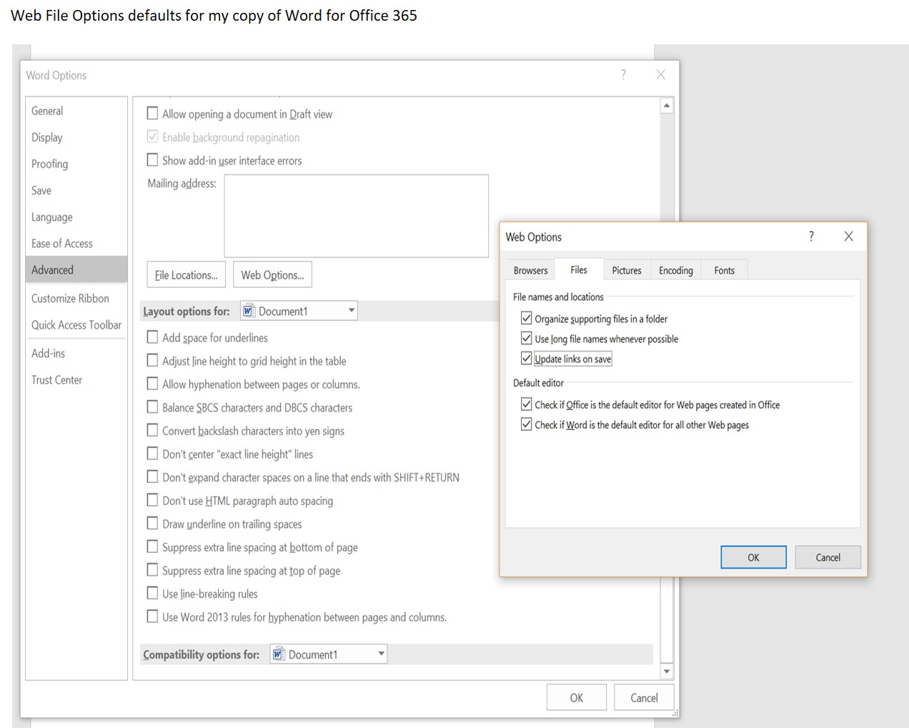

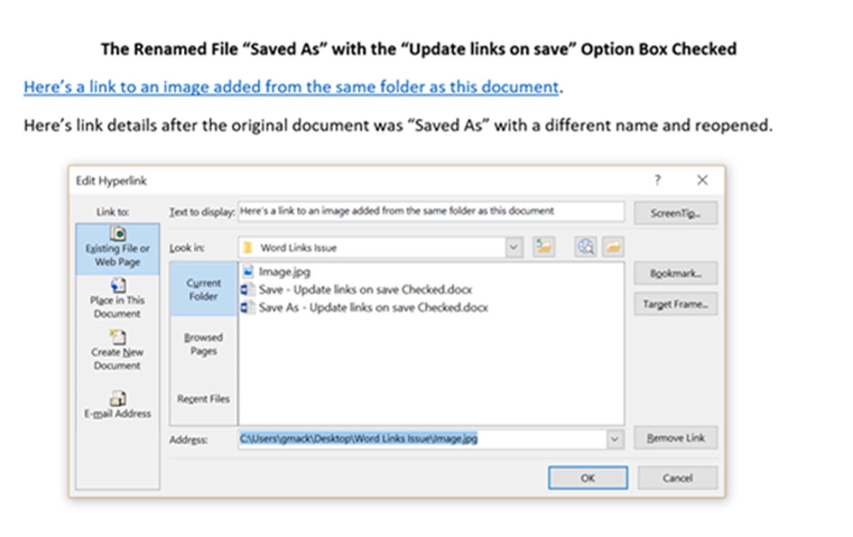

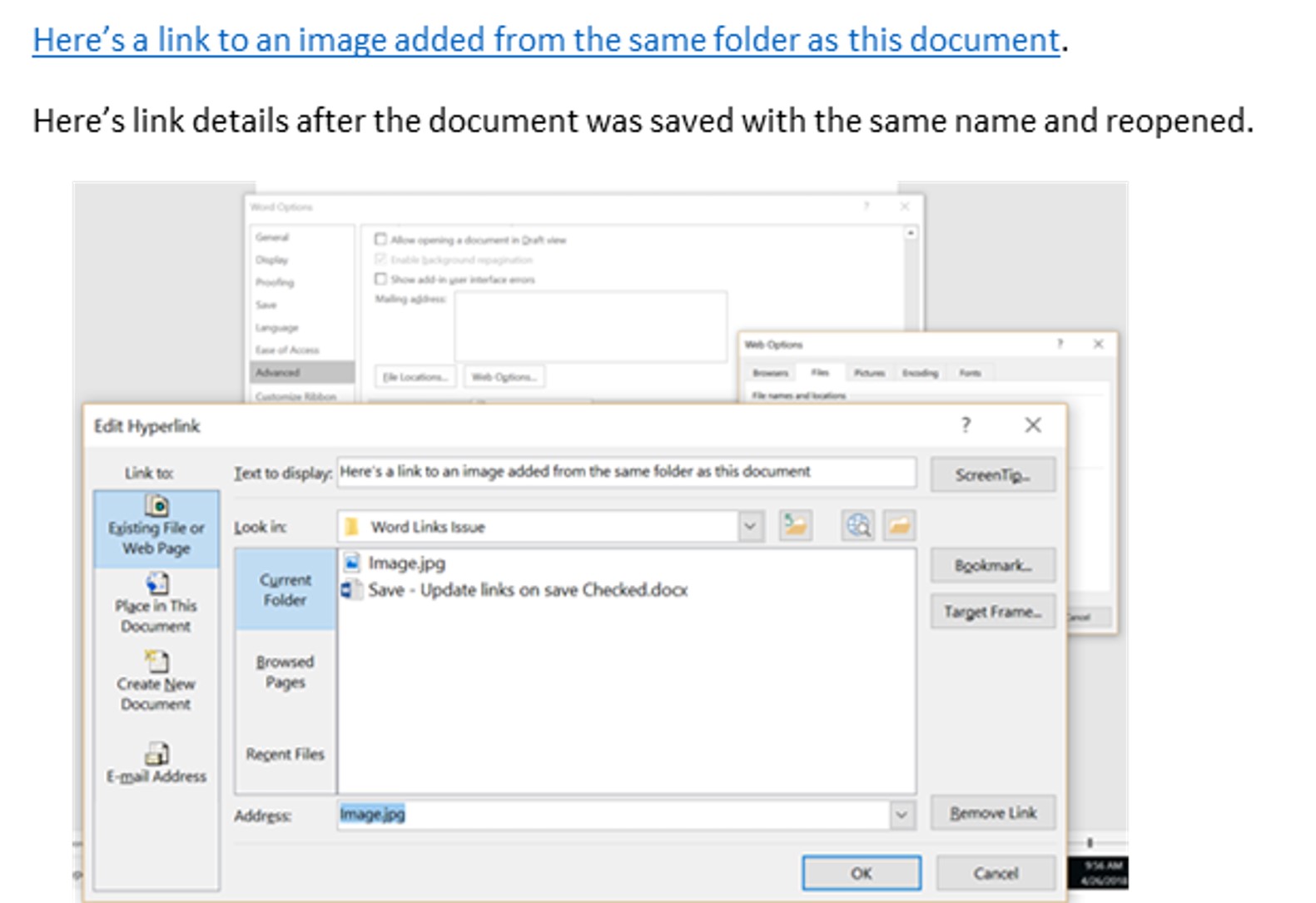

    2018-05-03T08:51:37+00:00
    Being able to upload Word documents to this forum could certainly be helpful. I believe you will have to post your suggestion in the Community Participation Center (https://answers.microsoft.com/en-us/feedback/forum).
    2018-05-03T14:39:19+00:00
    Being able to upload Word documents could certainly be helpful. I believe you will have to post your suggestion in the Community Participation Center (https://answers.microsoft.com/en-us/feedback/forum).
    Thanks - Will do!
    What is the next step in getting the underlying issue (the subject of this thread) properly addressed?
