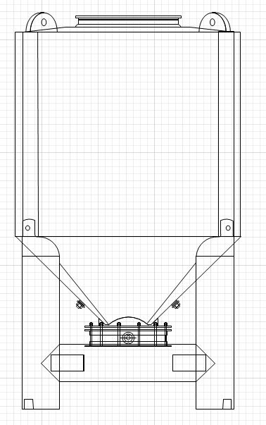

    Here is a shape of mine that I inserted into a blank drawing.
    Shape - (Solid Lines)

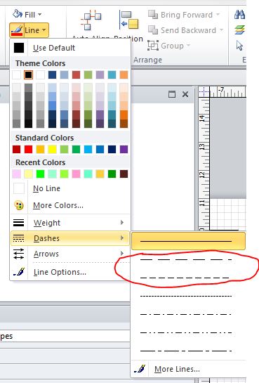

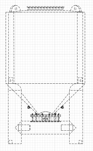

    So in that same drawing, if I change the shape to either of these type Dashed lines
    Shape - (Dashed Lines)
    .....then pan & zoom slow to a CRAWL.
    If I go back and change the shape back to solid lines --- Pan & Zoom work fine again.
    I don't know if this is the reason for the delays that everyone is experiencing, but this is what I have noticed in my experiences with Visio 2010.  Hopefully, something as simple as this could also apply for the problems everyone is experiencing in Visio 2013.
