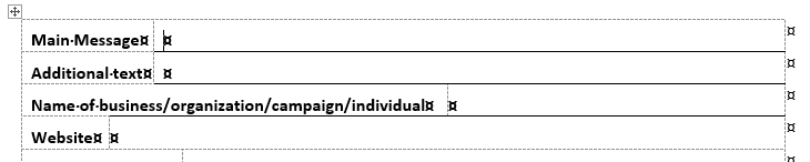

    We're getting closer! I do appreciate your efforts. While this does work, if the cells in the two rows aren't the same width, it still won't have the desired result. I'm using a table as a form that can be filled in, and the cells are all different widths to accommodate that.
    Note that the first two rows, in which the cells are aligned, worked fine. But the third row is not aligned with the ones above it. This is where adding a bottom border on the right cell added a border to both cells. But the cells in the row below are not aligned with the ones above, so while removing the top border from the cell below (Website) does work, it doesn't solve the problem in this case.

    It is indeed a stubborn bug! In the tests I made before posting the alternative solution I got the correct result each time. Obviously, I did not take the time to make enough tests. I did test with cells that had different widths and got correct results. If I create a table that looks like yours, I also get a wrong length of the bottom border in the problem cell when I remove the top border of the cell below it. This shows that the interrelationship between the cell widths makes a difference.

    Suzanne's solution works; however, there are some extra steps and one remaining glitch. I've revised the steps to reflect this:
    If you apply a bottom border to a selected cell and notice that extra cell(s) to the left get a border too:
    1. Undo at once to remove the applied border.
    2. Select the cell that must have a bottom border (RIGHT) + the cell to the left of it (LEFT).
    3. Apply a bottom border to the two cells.
    4. Select the row below (ROW B) and align the cell borders with those of the row above (ROW A).
    5. Select ROW B and restore the cell widths to where you want them to be.
    6. Select the Row B LEFT cell and remove the top border. If the left border of the ROW B RIGHT cell is to the right of the left border of the ROW A RIGHT cell, you are done.
    7. BUT, if the left border of ROW B RIGHT is to the left of the left border of ROW A RIGHT, you also need to select the ROW B RIGHT cell and remove the top border.
