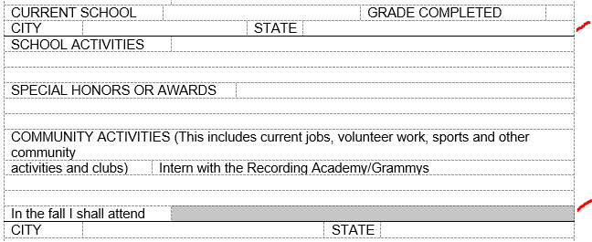

I have MS Word 2013 and from the Internet (from within Word) I searched for the keyword [ Form ] and downloaded a form that I am now trying to customize for my own needs.
The whole form is basically a table within the Word document. I want to be able to add a bottom border around a single cell from the table, but It isn't working ! When I add the border, it adds it to the whole row, not just the cell I specified.
The way I am trying to do it, is I right-click in the cell > Table Properties > Borders and Shading > In the Preview in the left, I click the bottom border for the cell, and in the Apply to drop-down I select Cell, then click OK, then OK again.
But it applies it to whole row (which is comprised of two cells), not just the single cell. Here is a screenshot. As you can see, the border is being place underneath the Telephone cell too !
Any help would be greatly appreciated.
Thank You.

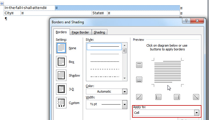

  2. Doug Robbins - MVP - Office Apps and Services 323.6K Reputation points MVP Volunteer Moderator
    2016-05-31T22:43:44+00:00
    Assuming that you are trying to do the same thing as the title of this post, put the cursor in the cell to which you want to add the bottom border and then access the Borders tab of the Borders and Shading dialog and select Cell in the Apply to dropdown and then click on the bottom border of the representation of the cell.
    ![](http://fud.community.services.support.microsoft.com/Fud/FileDownloadHandler.ashx?fid=85ab2256-eee5-409a-9c35-685d401dadbb)
    If that is not what you are wanting to do, tell use what it is.

  4. Doug Robbins - MVP - Office Apps and Services 323.6K Reputation points MVP Volunteer Moderator
    2016-06-02T20:03:50+00:00
    If you have the cell selected in the table and select "Cell" in the Apply to: dropdown on the Borders tab of the Borders and Shading dialog as shown below
    and you click on the appropriate place in the Preview diagram, the following will be the result:
