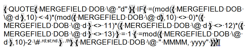

    Field code:
    Assuming that you are using mail merge, almost certainly DOB should be MERGEFIELD DOB.
    This works here:

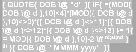

    Hi Doug,
    Thanks for your response - I've had a look at the website and am currently in the process of formatting as per their instructions.
    After taking a look I decided to go with the date format that includes the Ordinal st,th,rd etc. for each date.
    UPDATE:
    I have got the ordinal 'th' showing, however when I flick through the preview results, even when it comes to a date like the 3rd, it shows as 3th.. 21th etc.
    Would you be able to take a look at the attached picture and let me know where I may be going wrong?
    This is my first experience tampering with the field codes, so am not sure what to look for..
    Thank you.
    Field code:
