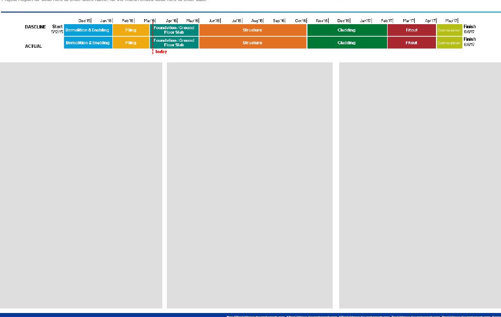

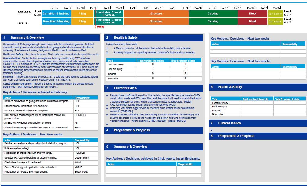

    No, it's the same result as if printing - whether I use 'save as' pdf or 'print to' adobe acrobat. The shape will usually print or be viewed in the pdf, but not the text or pictures. This is a shot of the document pdf before an image was added.
    And this is a shot of the document pdf after a picture was added into the text:
