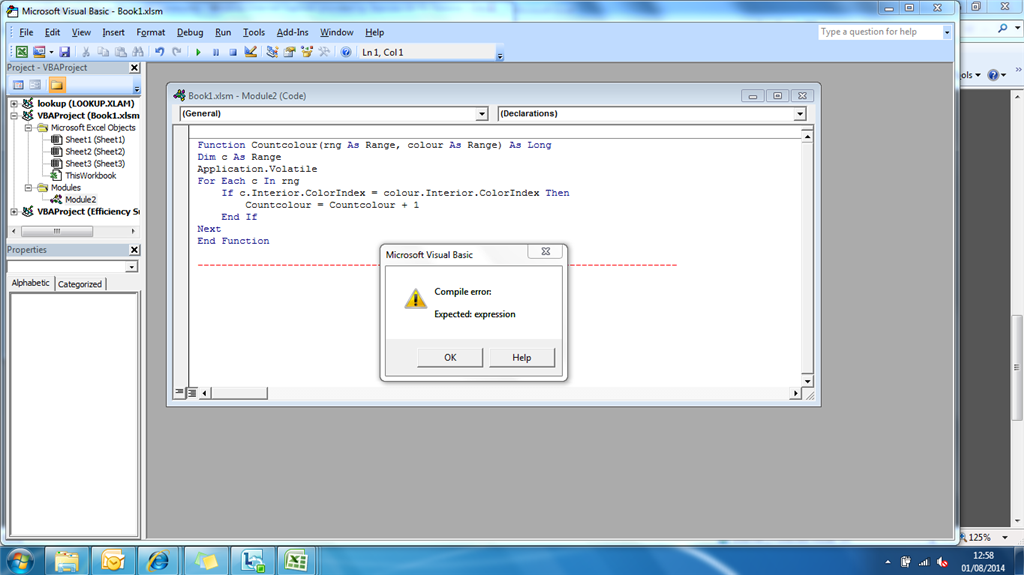

Excel has no native way of doing this so we must create a UDF to do it. ALT+F11 to open vb editor, right click 'ThisWorkbook' and insert module and paste the code below in. Close VB editor.
Back on the worksheet call with
=Countcolour($A$1:$J$1,K1)
Where:-
A1:J1 is the range you want to count
K1 is a cell with the fill colour you want to count.
Function Countcolour(rng As Range, colour As Range) As Long
Dim c as Range
Application.Volatile
For Each c In rng
    If c.Interior.ColorIndex = colour.Interior.ColorIndex Then
        Countcolour = Countcolour + 1
    End If
Next
End Function
