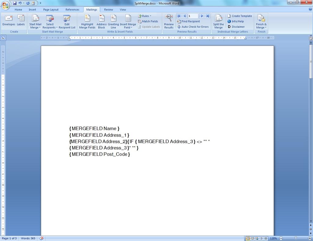

Using Word 2007, I am creating a mail merge. Some addresses have one line, some have two (Suite number, etc.) I want to suppress the second address field only if it is blank, so there are no blank lines in the document after I perform the merge. In older versions of Word, I remember a check box for "suppress blank fields" but I can't seem to find that in 2007.
Suzanne S Barnhill 279.4K Reputation points MVP Volunteer Moderator
2010-09-17T14:59:46+00:00
In general, blank lines are automatically suppressed, but only if they end in a paragraph break, not a line break. Consequently, the default is not a solution for me and perhaps not for you, either. So you have to use an IF field. Assuming your two address lines are the merge fields Address1 and Address2, you'd have something like this.
{ MERGEFIELD Address1 }<line break>
{ IF { MERGEFIELD Address2 } = "" "" "{MERGEFIELD ADDRESS2}<line break>" }
The way that will actually appear in your document is:
By putting the line break inside the FalseText quotes, you ensure that thereis a line break only if the line contains text; otherwise, there will be no line.
