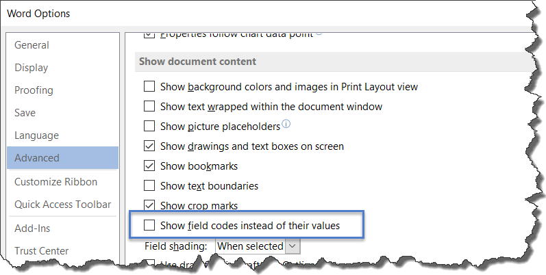

To change your DATE field to a CREATEDATE field, press Alt+F9 to display the field code. Then just type CREATE before DATE, press Alt+F9 to toggle back, and press F9 to update.
