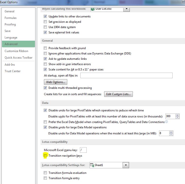

    This was happening in Excel 2013 and below is what fixed it:
    Excel options>Advanced. Under Lotus Compatibility, make sure the Transition Navigation Keys checkbox is not checked (see attached).
