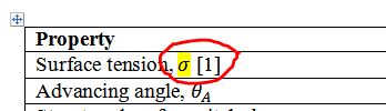

2012-07-01T08:55:50+00:00
I just had this problem too just after editing a table of equations, I managed to track down the problem and now I can save again.
Ill share it incase someone is in a similar situation:
I had put my references just behind the equations, either they merged or I had put them inside the equations myself. I could save again if I removed the equations and added them outside the equations with a space in between.
