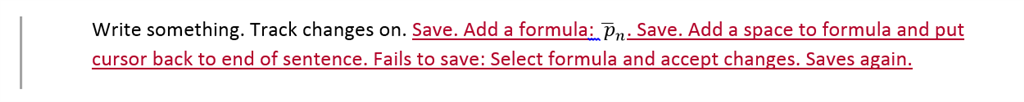

I just had this problem too just after editing a table of equations, I managed to track down the problem and now I can save again.
Ill share it incase someone is in a similar situation:
I had put my references just behind the equations, either they merged or I had put them inside the equations myself. I could save again if I removed the equations and added them outside the equations with a space in between.

    I had the same problem. I think I found, at least in my case, the source of the problem - It was the \approx symbol ≈ that I used while in Math mode. I deleted it and the problem stopped happening.

    In my case it turned out to be a problem with embedded equations.  While converting from MathType to Microsoft Equation, I inadvertently embedded a MathType equation segment inside a Microsoft Equation box.  It is understandable that this would be difficult to save and that there would be no clean mechanism to identify, the specific problem.  It is a surprise to me, however, that the location of the problem is not identified, only the error message "A file error has occurred". This message is non-specific, appears to describe a very wide range of problems ,and Microsoft gives no guidance as to what to look for or how to recover from this error. It's reminiscent of the early days of DOS and meaningless, general error messages.
