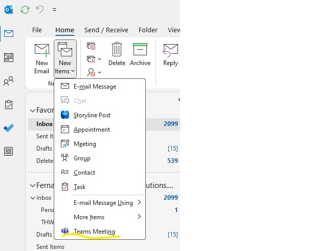

    I was having the same issue...figured out that to create a TEAMS meeting I now need to go to Home-> New Items - > Teams Meeting
