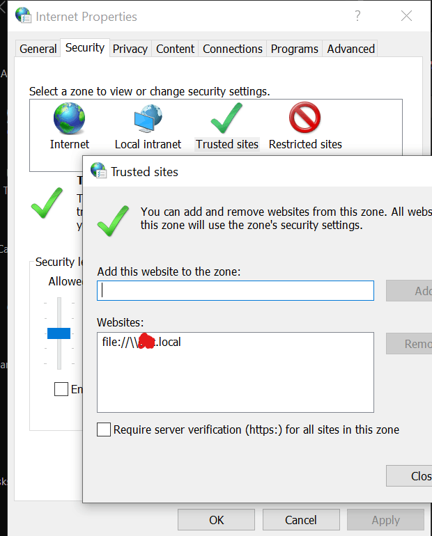

    Also for working links with the Host name only not FQDN the following dialog is raised on a trusted domain that was not raised previously when clicked.
