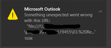

Hyper links wont open and I get the error message.

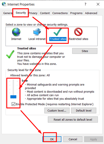

    I found the same issue but i can fix it now.
    Please try solution as below.
    > go to Control Panel >> Internet Option >> add URL, UNC, FQDN path that you want to allow
    > Adjust the scale down and select Enable Protected mode
    Hope will help to fix your problem

    Seeing the same error, this appears to be across several different versions of Microsoft 365, so I'm suspecting something in the most recent patch Tuesday updates for Windows 10, all reports of the issue started yesterday after users starting rebooting following the patch Tuesday windows updates.
    We are seeing this on Builds:
    • 16501.20196 - 2305
    • 16529.20154 - 2306
    For file URL's which has me specifically suspecting Windows and not a particular office build or update, since these are older stable builds.
    I have further traced the issue with users on our side and found that file links with an FDQN (raise the
    error)
    Those with just a host name raise a security warning first then work.
    NOT working (FQDN within link)
    \filestore.domain.ca\docs\docsample.pdf
    file://filestore.domain.ca/docs/docsample.pdf
    Working (Host name only within link)
    \filestore\docs\docsample.pdf
    file://filestore/docs/docsample.pdf

    Seeing it here as well. It's not web URLs that are the issue, it's file path URLs.

    Grrr... same issue here.
    file:///\servername.domain.local\filepath => doesn't work
    file:///\servername\filepath => works
    It seems that FQDN is now broken in Outlook / File Explorer :(
    2023-07-13T07:14:21+00:00
    looks like its users that are on version 2305
    we get the notification below :
    if you try the new version of outlook, you get a security pop up
    we have a cpl of users not updated and they are ok
    and i don't think there is a way to roll back the office install version
