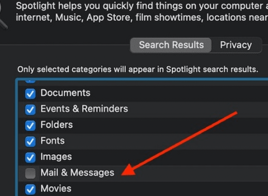

    For Mail, I'll assume this is checked:
