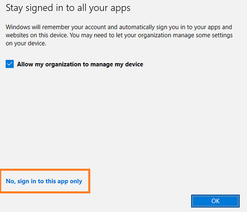

    Hello Steve Hanley,
    If convenient, I consider you could try to check account in Access work or school in Windows settings, disconnect your account from there. Then try to add account in Outlook, when below page prompts, select “No, sign in this app only” to test if this way works:

    I have a similar case with one of our users, while he is using more than one account, the login id / email is different between the accounts.
    Using the "only sign into this app" helps to some degree, he still gets authentication popups all the time which makes it a pain to work.
