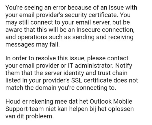

    3. Can future versions of the software not point us in the the wrong direction? In my case the problem was clearly STARTTLS, Yet
      1. First the Outlook client says: Login Error, The connection to your mail server timed out. Such a strange text, because the client disconnected from our SMTP-server immediately. Nothing is kept waiting.
      2. Next, the outlook client leads me to the text below, which is really not the point. The certificate was fine already. All I needed was to change the server config by replacing the STARTTLS setup with a pure TLS one. Both setups are depending on the same certificate.
