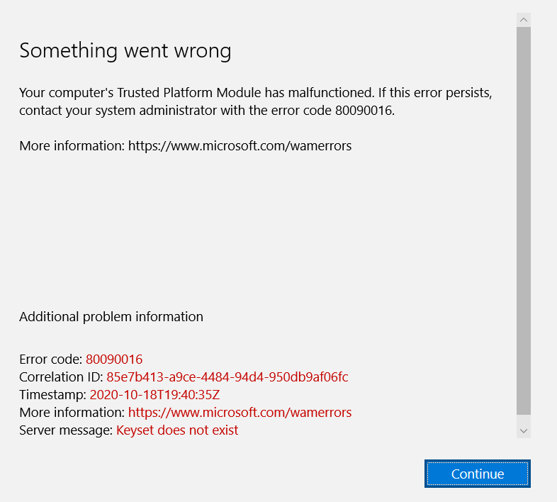

Outlook 2016 with Office 365 account keeps prompting for password. After entering it, an error pops up "Your computer's Trusted Platform Module has malfunctioned. If this error persists, contact your system administrator with the error code 80090030. It affects Outlook login only.

The word on the street is that Outlook is wanting MFA.  So either you have to turn on MFA or disable ADAL
Fix get them onto MFA or
Close Outlook
Open Regedit
HKEY_CURRENT_USER\Software\Microsoft\Office\16.0\Common\Identity
Create REG_DWORD
EnableADAL
0

Hi Sam,
Based on the error message, the issue is related to Trusted Platform Module(TPM). You need to check whether your TPM works correctly. You try to back up your data and clear TPM. It will reset your security processor to its default settings. For your reference:

    For those that might follow....   None of this involved data loss:
    If this is a DELL machine.
    In Windows - RUN - tpm.msc.  If no TPM reported.
    Tap F2 during boot to enter BIOS - look for TPM - if there - re-enable.  Save and reboot.
    If TPM is missing from BIOS - go to support.dell.com and enter machine service tag.  Download BIOS update, run, follow promptsand allow to reboot machine.
    On reboot - Tap F2 during boot to enter BIOS - look for TPM - if there - re-enable (or confirm it is enabled).  Save and reboot.
    One other wrinkle - if the TPM doesn't reappear after a BIOS update.
    Shut machine down, Remove power cord.  Hold power button in for 60+ seconds to drain 'flea' power.  Reconnect power
    cord and reboot.
