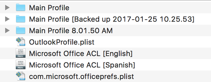

    Update this morning: I got a little more aggressive deleting files and keychain entries, and was successfully able to add my account. I won't know until later if the problem will return after I quit/logout/etc., but for now, what I did has worked. Attached is a screen shot of the files that I deleted that had been in /Library/Group Containers/UBF8T346G9.Office. The Profile folders were inside the Outlook/Outlook 15 Profiles folder inside the UBF8T... folder.
    I also deleted every single entry in Keychain Access that showed up when I searched for "Office," "Exchange," or "ADAL," not just application passwords but the files that have the blue "@" symbol next to them and long strings of letters and numbers, and are the kind "MicrosoftOffice15_2_Data:....."
    Like I said, not sure if the problem will return, but I'm up and running for now.
