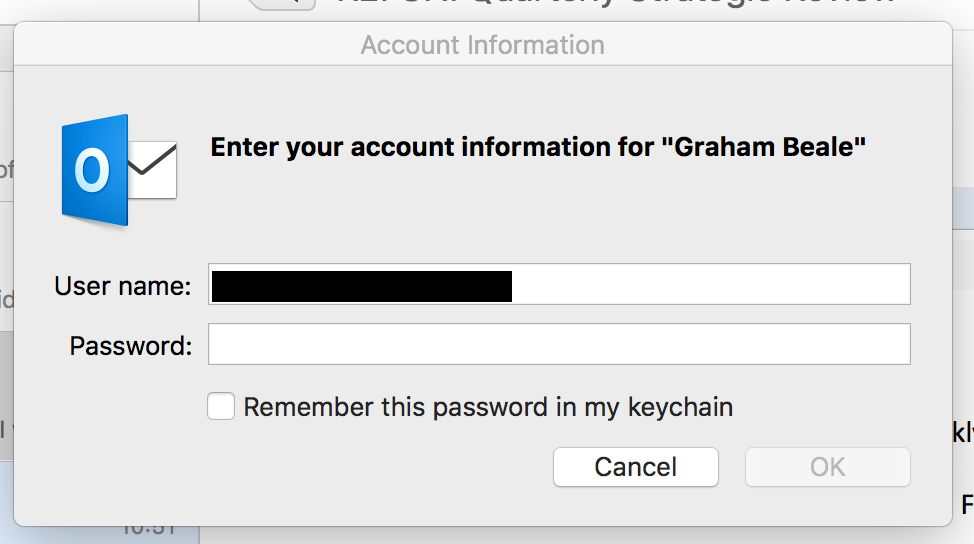

Essentially my mac outlook keeps asking for my password periodically:
Enter your account information for "XXXXXX"
User name: <My email address>
Password: <unpopulated>
<checkbox> Remember this password in my keychain
When I enter the password, and submit the form it asks me immediately for the same details again. Even if I select use keychain.

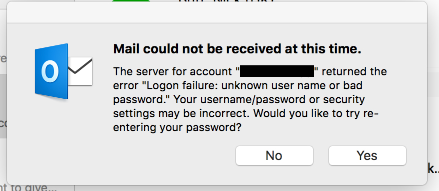

Then after two attempts, it shows me this message:
Mail could not be received at this time.
The server for account "<my name>" returned the error "Logon failure: unknown user name or bad password." Your username/password may be incorrect. Would you like to try re-entering your password?
No/Yes
If I click "Yes" it shows me the same dialogue again....and when I click "yes" again it disappears.

    2017-01-06T11:26:04+00:00
    Hi Sam,
    I deleted all my keychain folder completely yesterday (due to an unrelated issue with the messages app), but the dialogues are still appearing from outlook.
    In answer to your questions:
    1. Outlook version is 15.29 (161209)
    2. Exchange (365)
    3. Photos below
