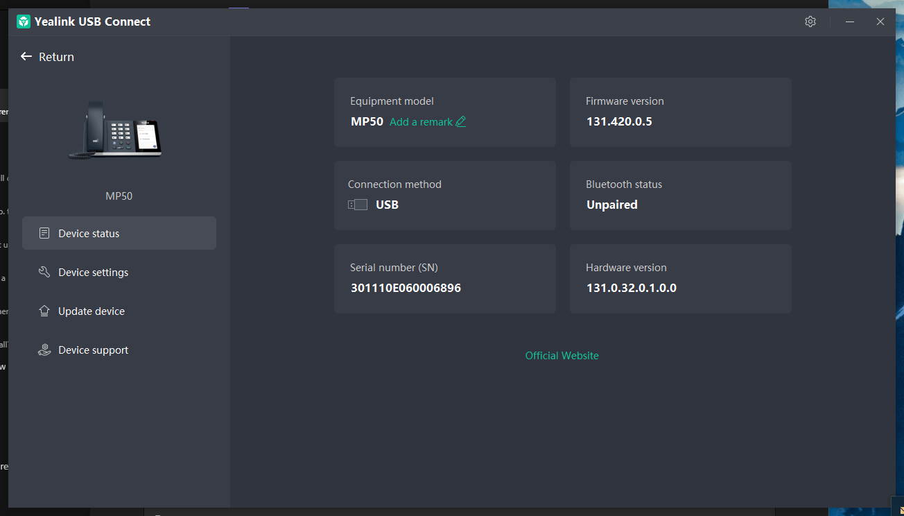

    I am unable to dial a phone call using the PC Softphone option with Teams. It looks like it's trying to make the call initially, but then it just returns to the menu again without actually doing anything. I noticed in the Yealink USB Connect settings under Softphone Settings, it says "No supported softphone detected". I am not sure if this is normal, but so far I can not get it to work.
    I've tried both preview and standard releases of Microsoft Teams, and currently the Yealink USB Connect software is the latest. So far none of the 12 MP50 phones, and all of them are having the same issue.
