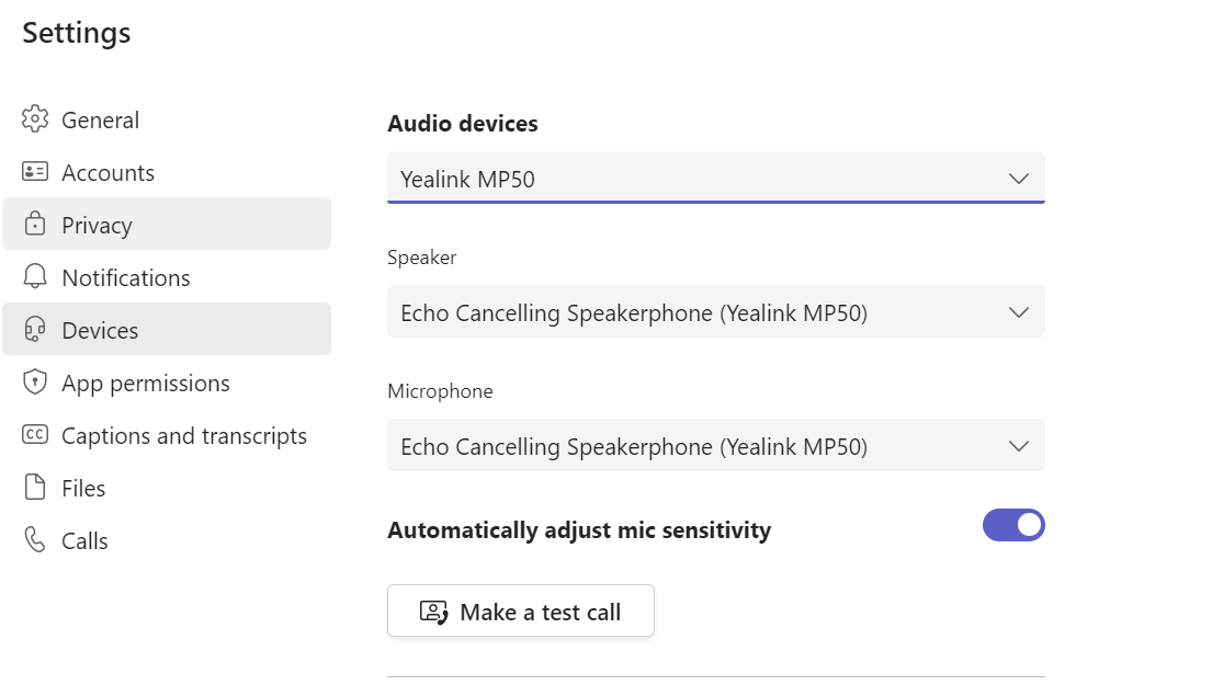

    I assume you have Teams version Teams 1.5.00.25769(64bit) from a Public Preview (as I did). That's the only non-standard part of the set-up I have.
    I'm sure this hasn't been overlooked given how many times you appeared to have tried and tested this, but when people have tested on 1.5.00.25769, have they made sure to set the Yealink as the audio device in the Teams client?
    I only ask as I made that mistake a couple of times when testing in haste.
