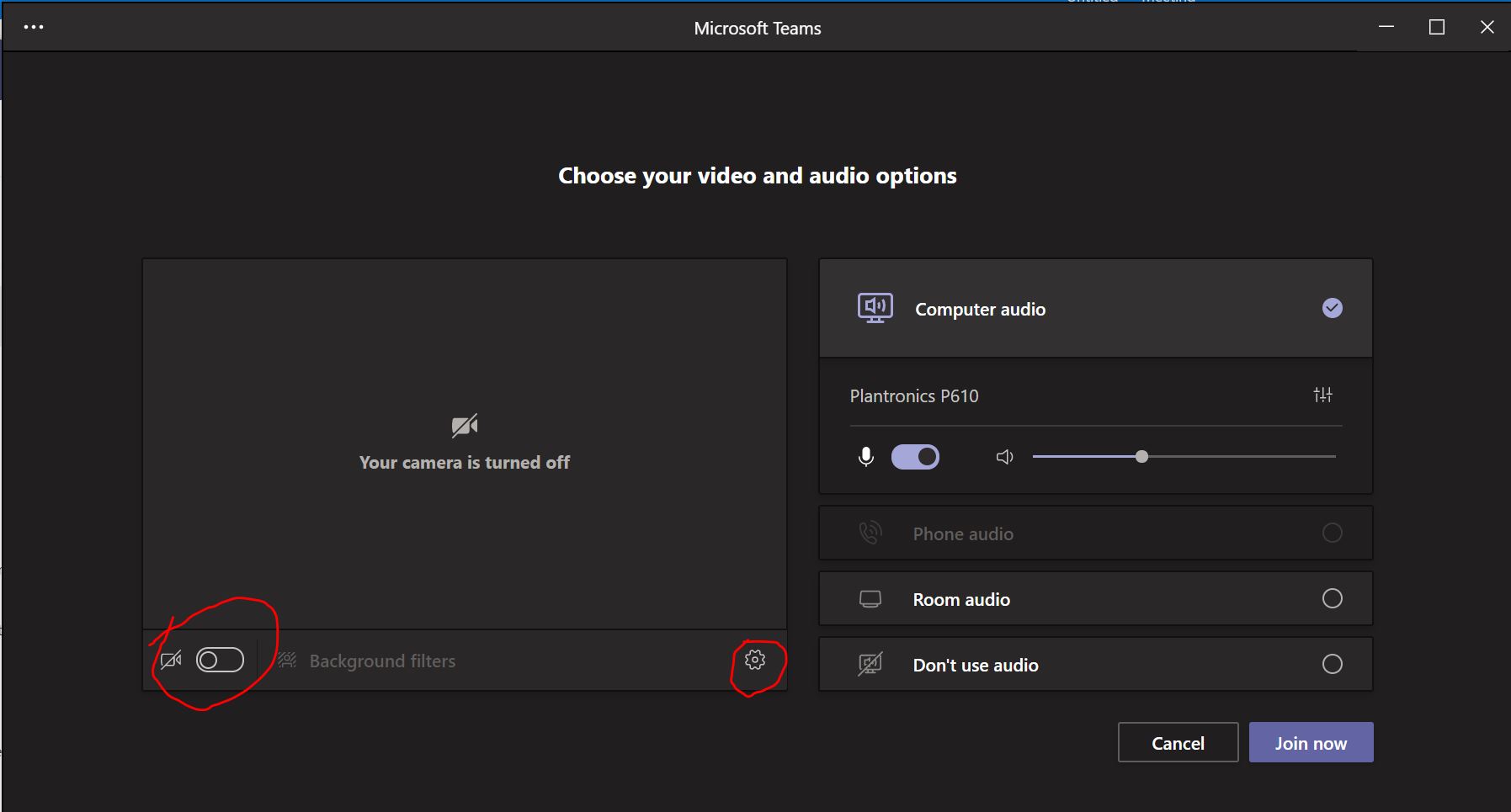

    Before you join the meeting you can turn te camera off and/or adjust the settings
