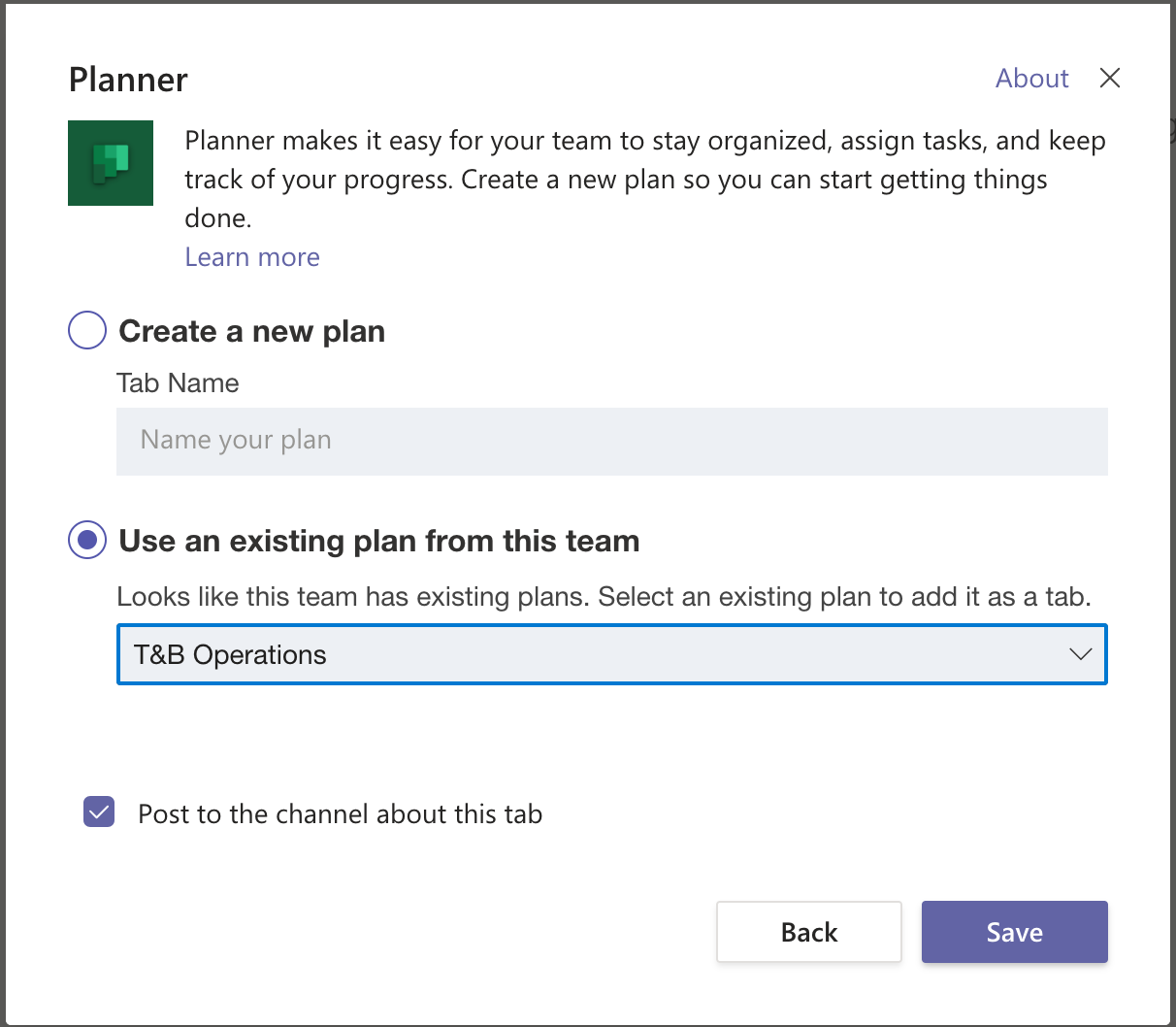

My team at work has a plan that was created in Planner.  We now want to also start using Teams, but we are unable to link the existing plan to Teams.  When we try to add a Planner tab to a channel, we get the option to "Use an existing plan from this team" or create a new plan, but there's no option to link to an already existing plan in Planner.  Does anyone know how to do this, or can you only link to plans that were created in Teams?

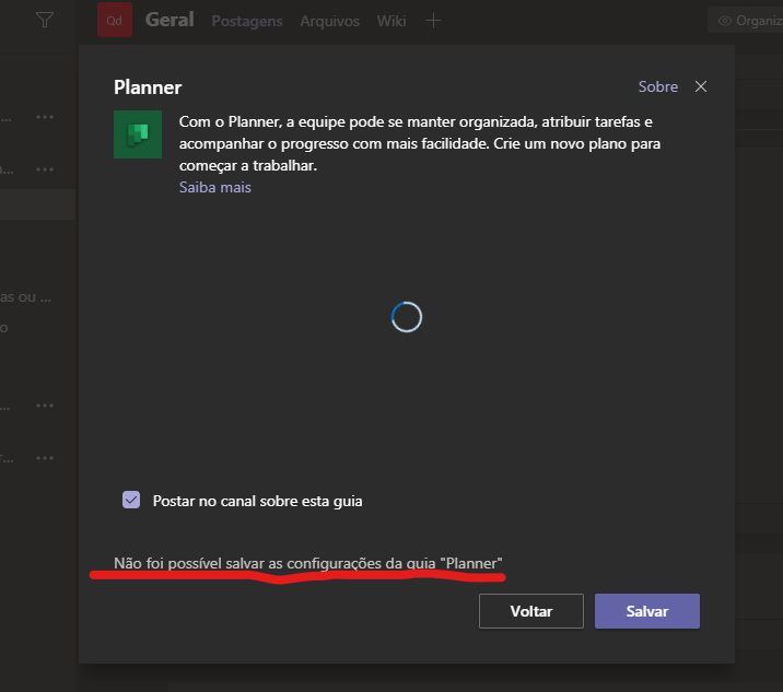

    I believe I have the same problem.
    I get the the result below when I try to add an existing plan as a tab on a Team.
