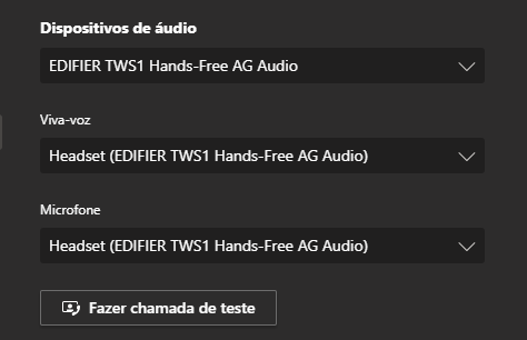

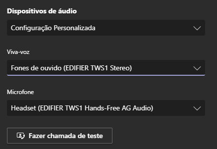

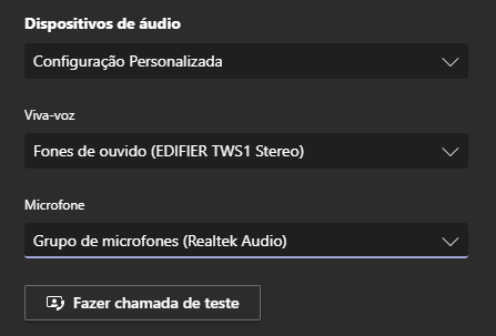

    Same here.
    This works both sound with poor quality and mic:
    This works sound with good quality and mic with poor quality (since my laptop mic is not good):
    And finally, this doesn't work the sound at all but the mic still works (good quality):
