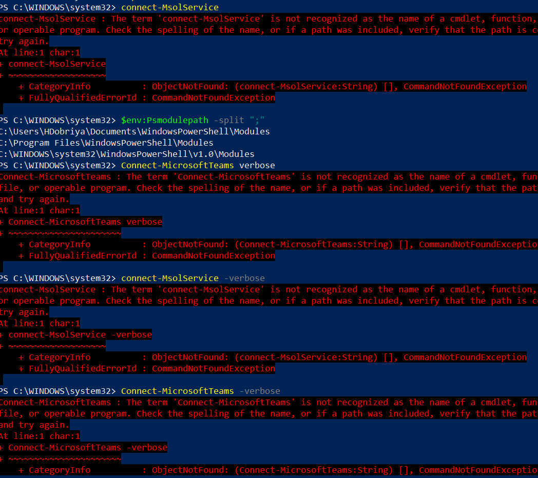

Hi Team, Please advice am i doing something wrong
PS C:\WINDOWS\system32> find-Module -Name MicrosoftTeams
Version    Name                                Repository           Description
1.0.2      MicrosoftTeams                      PSGallery            Teams Cmdlets module
Installed module using - install-Module -Name MicrosoftTeams.
Getting error when run     Connect-MicrosoftTeams
PS C:\WINDOWS\system32> Connect-MicrosoftTeams
Connect-MicrosoftTeams : The term 'Connect-MicrosoftTeams' is not recognized as the name of a cmdlet, function, script
file, or operable program. Check the spelling of the name, or if a path was included, verify that the path is correct
and try again.
At line:1 char:1
  • Connect-MicrosoftTeams
    + CategoryInfo          : ObjectNotFound: (Connect-MicrosoftTeams:String) [], CommandNotFoundException
    + FullyQualifiedErrorId : CommandNotFoundException
54 answers
    2020-03-15T09:56:41+00:00
    Thanks for sharing.
    How do i install an earlier version? do i have to uninstall my current version?
    Yes, you first uninstall the newer or current  version with :
    Uninstall-Module MicrosoftTeams
    then you install the version you want / need :
    Install-Module -Name MicrosoftTeams -RequiredVersion 1.0.0
    2020-03-16T17:00:32+00:00
    I am getting same error in ISE also.
    2020-03-16T19:51:40+00:00
    there is no difference between powershell and powershell ISE regarding to the teams module,
    so the solution is the same, unistall the current version and install an older version by running :
     and then you install the version you want / need :
    Install-Module -Name MicrosoftTeams -RequiredVersion 1.0.0 or
    Install-Module -Name MicrosoftTeams -RequiredVersion 0.9.5 (we seem to have other problems with 1.0.0)
    2020-03-21T17:00:14+00:00
    You need to execute Import-Module MicrosoftTeams after Install-Module.
    2020-04-10T15:02:55+00:00
    I'm having exactly the same problem. Install-Module -name MicrosoftTeams is not working for me either.
    It appears the package 0.9.5 is not available for automatic download and install either so I am going to try an earlier version. Is there any estimate on a date this will be fixed?
