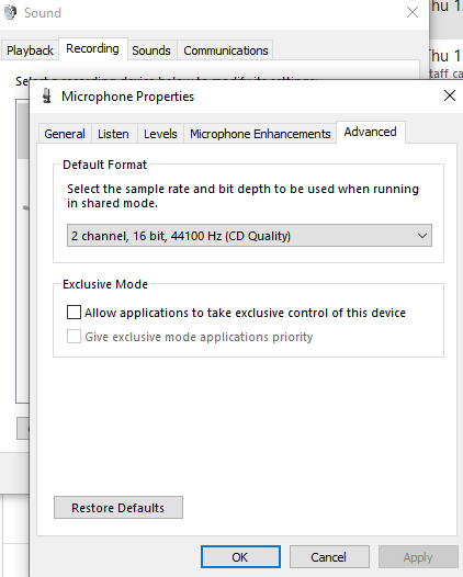

    I had this same problem and found a solution that works for me using windows 10 + teams.  In my case my microphone worked before, but was picking up very quietly in teams and fine in other applications. Please try this:
    1. Next to the start menu search box, search for "sound" >> Open "Sound Settings"
    2. Select sound from the left menu bar
    3. Scroll down to related settings and select "Sound control panel"
    4. Select "Recording" tab
    5. Click the device for your microphone, e.g. "microphone array"
    6. Click properties
    7. Select the "levels" tab
    8. Slide "Microphone boost" up to +20dB
    9. Hit ok and then try testing your microphone again.
    I just stumbled into this looking for the microphone settings so if it doesn't work try the other sliders in the levels tab as well.
