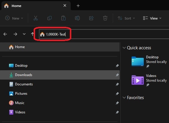

    If you are on Computer #2 and trying to access Computer #1 on a windows home network, do the following:
    1. Go to computer #1 and log in using your password (not your PIN) to ensure it is locally cached on computer #1. If you have never logged in using anything except a PIN, you will need to log in at least once using your password.
    2. Make a note of computer #1's username and password. The username will usually be the email address associated with your Microsoft account
    3. Go to computer #2 and when prompted for your network credentials, type in the username and password for computer #1
