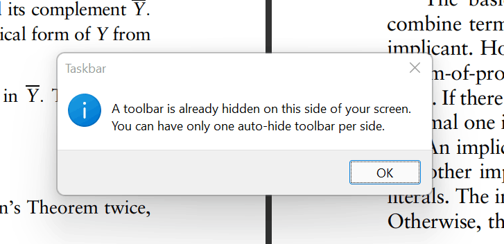

I switched to Windows 11 a few weeks ago, and ever since then, the taskbar auto-hide quits working when the computer comes out of Sleep mode. I have to be away from the computer for a while before it will happen, and I believe it has something to do with me running dual monitors. When I wake my computer, my secondary monitor appears to come up faster than my primary by just a fraction. Once my primary is on, there is a message saying something about the taskbar already being hidden (I think) and the taskbar on my primary monitor has the taskbar up. When I go to Taskbar Behaviors, 'Automatically hide the taskbar' is no longer checked. I'll select it again, and it will work fine until the system goes back into Sleep mode for a while, again.

    2022-03-20T15:18:14+00:00
    I managed to take a screenshot

    I found this thread through a google search. After reading a few other things, none of which fully defined the issue, I thought there is a possibility that Windows Explorer is not saving the setting then it goes through both the sleep or restart events. I tested my theory and proved this correct. I then reset the flag and signed out as a user thinking an orderly shutdown may occur and the flag would be saved. It did the trick. Now the flag is still set whether it sleeps or restarts. However, I would think this works both ways and would have to go through the same procedure to permanently turn it off. :)
