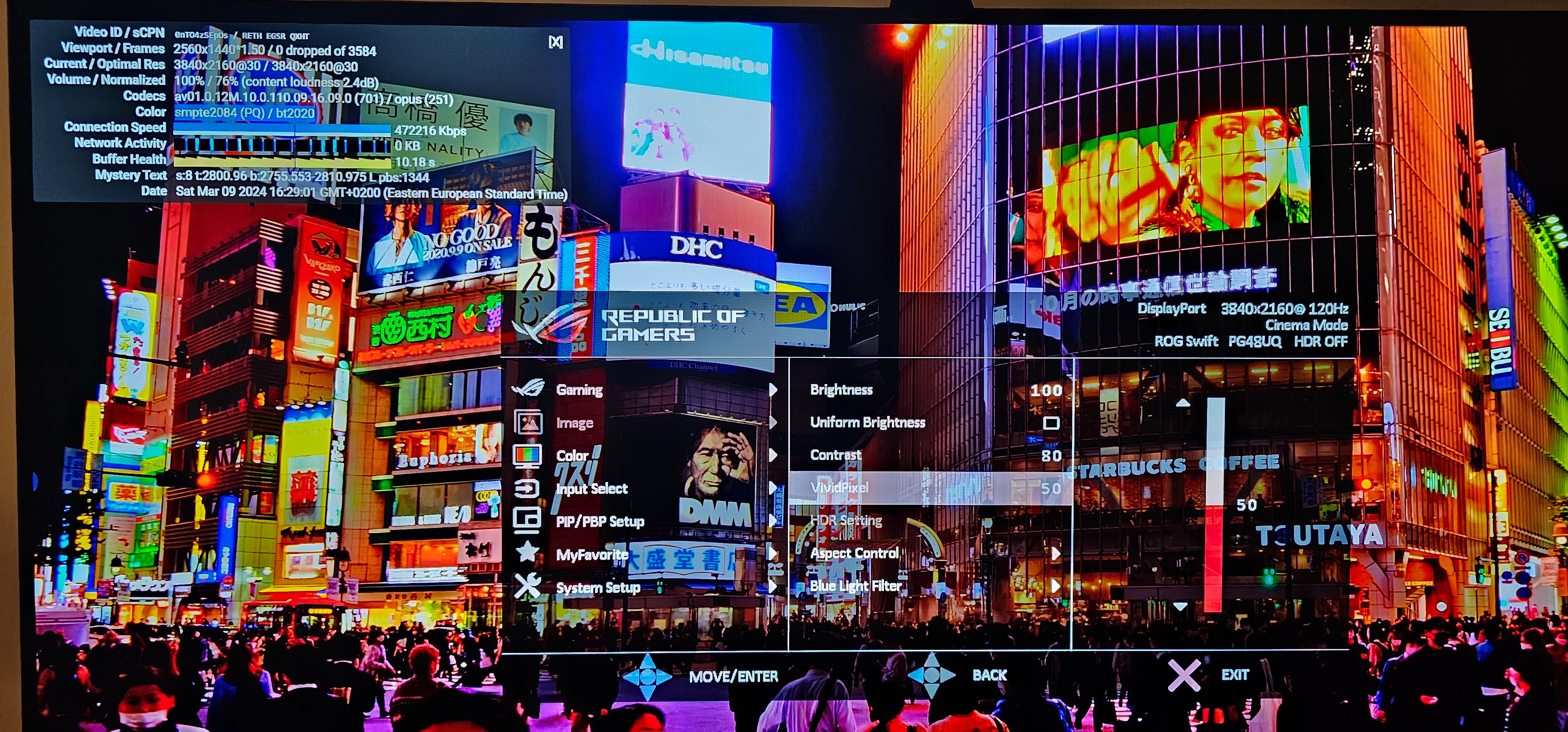

    And yes, I followed your guide, and I can confirm that the browser can NOT enable HDR for the monitor, even when it's forced use the incorrect HDR color format that doesn't match the configured display settings. This is how it looks like with the OSD and stats for nerds open, video playing in full screen, after following the guide:

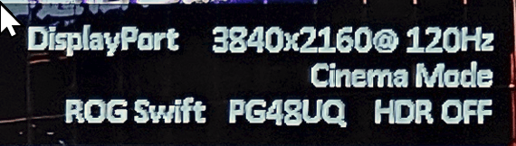

    As you can see, despite the color format coming from YouTube being HDR because I used your guide to force it to use an incorrect format, the monitor still has HDR turned off, if you look at the monitor OSD:
    It's Windows and the display driver doing the conversion back to SDR, since the actual video link between the computer and the display is SDR.

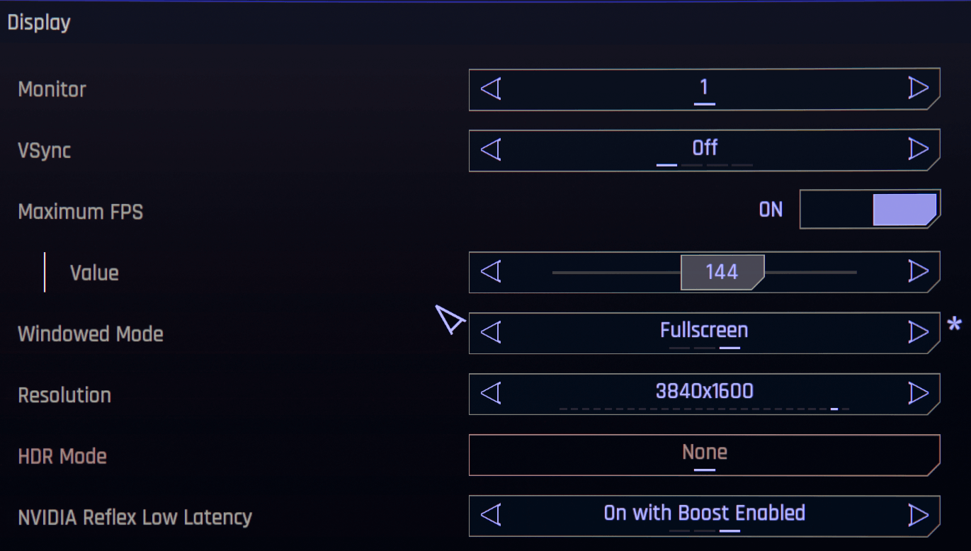

    Cyberpunk 2077 is not one of the games that would allow you to incorrectly enable HDR, if it's not enabled in Windows for the display. The game settings will look like this after you disabled HDR in Windows:
    As you see, the HDR Mode is disabled in Cyberpunk 2077 when HDR is turned off for the display in Windows. Yes, you can trick it by starting the game, enabling HDR in game, then disabling the HDR setting in Windows, since the game only checks for HDR availability in Windows at game startup, but then you will end up with the same problem as with the browser. Windows and the display driver will convert the incorrectly HDR rendered content back to SDR while HDR is disabled in Windows.

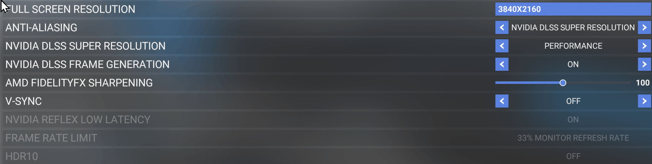

    Microsoft Flight Simulator also doesn't allow you to use incorrect settings when you disable HDR in Windows:
    And, again, since it also checks the Windows HDR status for the display only at startup, you can trick it by disabling HDR in Windows after starting it. But Windows and the driver will just convert the incorrectly HDR rendered output to SDR if you do that.

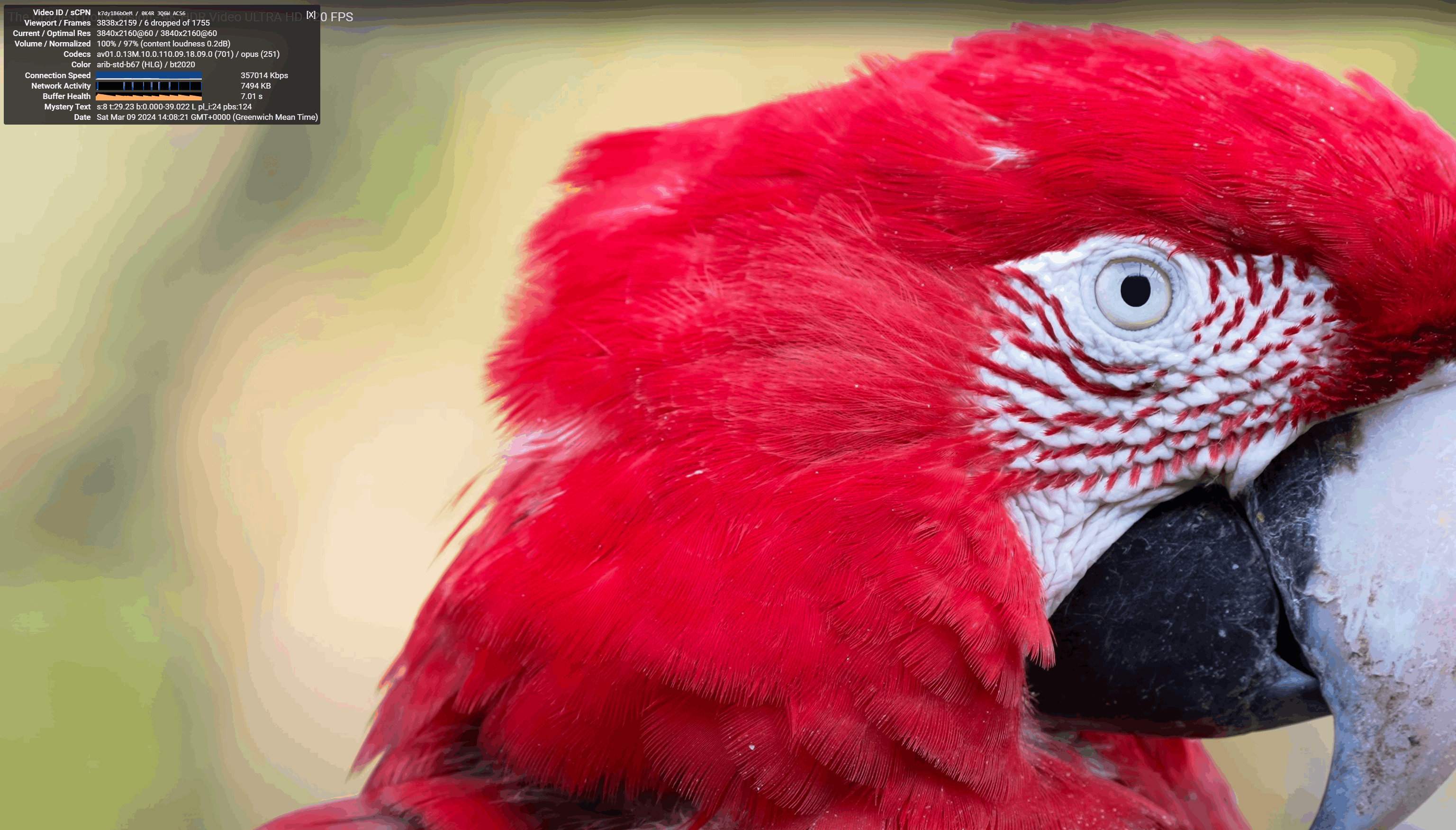

    Here is another YouTube video (Using Edge) in 4K HDR and Desktop HDR disabled:
