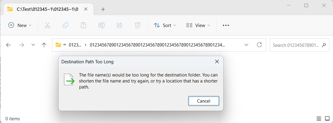

    If you can navigate and edit long paths at a Cmd prompt, without having to use the *\?* prefix, then that means the LongPathsEnabled setting is working correctly.
    However, Explorer (even the latest version in 23H2) does NOT support long paths, regardless of the LongPathsEnabled setting. You can navigate long paths with Explorer, but you cannot make any change that will extend the path.

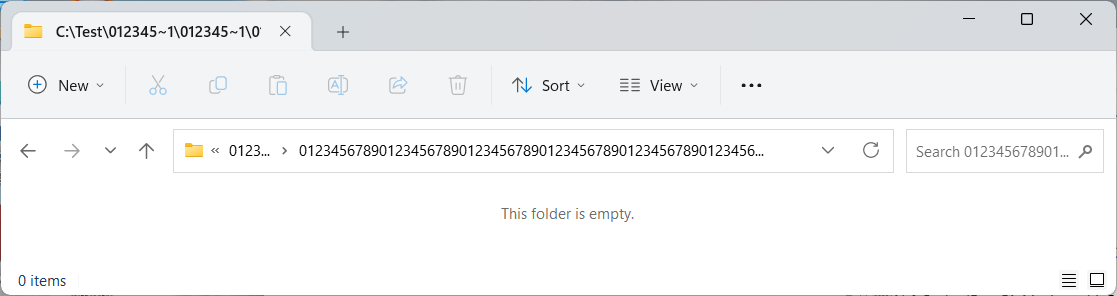

    I found that I can paste files from the clipboard into deep folders in explorer. But, there's a limit how deep explorer can go.
    While testing I found a limit at about 18K bytes. I made a deep folder 200 deep where each folder was 100 bytes. Once you get to about 18,195 bytes in, Explorer refuses to enter that folder. I tried right clicking on the folder and selected "copy as path" here's what I got:
    "\?\D:\longpath\o123456789o123456789o123456789o123456789o123456789o123456789o123456789o123456789o1234_ThisIs100bytes\o123456789o123456789o123456789o123456789o123456789o123456789o123456789o123456789o1234_ThisIs200bytes\o123456789o123456789o123456789o123456789o123456789o123456789o123456789o123456789o1234_ThisIs300bytes\o123456789o123456789o123456789o123456789o123456789o123456789o123456789o123456789o1234_ThisIs400bytes\o123456789o123456789o123456789o123456789o123456789o123456789o123456789o123456789o1234_ThisIs500bytes\o123456789o123456789o123456789o123456789o123456789o123456789o123456789o123456789o1234_ThisIs600bytes\o123456789o123456789o123456789o123456789o123456789o123456789o123456789o123456789o1234_ThisIs700bytes\o123456789o123456789o123456789o123456789o123456789o123456789o123456789o123456789o1234_ThisIs800bytes\o123456789o123456789o123456789o123456789o123456789o123456789o123456789o123456789o1234_ThisIs900bytes\o123456789o123456789o123456789o123456789o123456789o123456789o123456789o123456789o123_ThisIs1000bytes\o123456789o123456789o123456789o123456789o123456789o123456789o123456789o123456789o123_ThisIs1100bytes\o123456789o123456789o123456789o123456789o123456789o123456789o123456789o123456789o123_ThisIs1200bytes\o123456789o123456789o123456789o123456789o123456789o123456789o123456789o123456789o123_ThisIs1300bytes\o123456789o123456789o123456789o123456789o123456789o123456789o123456789o123456789o123_ThisIs1400bytes\o123456789o123456789o123456789o123456789o123456789o123456789o123456789o123456789o123_ThisIs1500bytes\o123456789o123456789o123456789o123456789o123456789o123456789o123456789o123456789o123_ThisIs1600bytes\o123456789o123456789o123456789o123456789o123456789o123456789o123456789o123456789o123_ThisIs1700bytes\o123456789o123456789o123456789o123456789o123456789o123456789o123456789o123456789o123_ThisIs1800bytes\o123456789o123456789o123456789o123456789o123456789o123456789o123456789o123456789o123_ThisIs1900bytes\o123456789o123456789o123456789o123456789o123456789o123456789o123456789o123456789o123_ThisIs2000bytes\o123456789o123456789o123456789o123456789o123456789o123456789o123456789o123456789o123_ThisIs2100bytes\o123456789o123456789o123456789o123456789o123456789o123456789o123456789o123456789o123_ThisIs2200bytes\o123456789o123456789o123456789o123456789o123456789o123456789o123456789o123456789o123_ThisIs2300bytes\o123456789o123456789o123456789o123456789o123456789o123456789o123456789o123456789o123_ThisIs2400bytes\o123456789o123456789o123456789o123456789o123456789o123456789o123456789o123456789o123_ThisIs2500bytes\o123456789o123456789o123456789o123456789o123456789o123456789o123456789o123456789o123_ThisIs2600bytes\o123456789o123456789o123456789o123456789o123456789o123456789o123456789o123456789o123_ThisIs2700bytes\o123456789o123456789o123456789o123456789o123456789o123456789o123456789o123456789o123_ThisIs2800bytes\o123456789o123456789o123456789o123456789o123456789o123456789o123456789o123456789o123_ThisIs2900bytes\o123456789o123456789o123456789o123456789o123456789o123456789o123456789o123456789o123_ThisIs3000bytes\o123456789o123456789o123456789o123456789o123456789o123456789o123456789o123456789o123_ThisIs3100bytes\o123456789o123456789o123456789o123456789o123456789o123456789o123456789o123456789o123_ThisIs3200bytes\o123456789o123456789o123456789o123456789o123456789o123456789o123456789o123456789o123_ThisIs3300bytes\o123456789o123456789o123456789o123456789o123456789o123456789o123456789o123456789o123_ThisIs3400bytes\o123456789o123456789o123456789o123456789o123456789o123456789o123456789o123456789o123_ThisIs3500bytes\o123456789o123456789o123456789o123456789o123456789o123456789o123456789o123456789o123_ThisIs3600bytes\o123456789o123456789o123456789o123456789o123456789o123456789o123456789o123456789o123_ThisIs3700bytes\o123456789o123456789o123456789o123456789o123456789o123456789o123456789o123456789o123_ThisIs3800bytes\o123456789o123456789o123456789o123456789o123456789o123456789o123456789o123456789o123_ThisIs3900bytes\o123456789o123456789o123456789o123456789o123456789o123456789o123456789o123456789o123_ThisIs4000bytes\o123456789o123456789o123456789o123456789o123456789o123456789o123456789o123456789o123_ThisIs4100bytes\o123456789o123456789o123456789o123456789o123456789o123456789o123456789o123456789o123_ThisIs4200bytes\o123456789o123456789o123456789o123456789o123456789o123456789o123456789o123456789o123_ThisIs4300bytes\o123456789o123456789o123456789o123456789o123456789o123456789o123456789o123456789o123_ThisIs4400bytes\o123456789o123456789o123456789o123456789o123456789o123456789o123456789o123456789o123_ThisIs4500bytes\o123456789o123456789o123456789o123456789o123456789o123456789o123456789o123456789o123_ThisIs4600bytes\o123456789o123456789o123456789o123456789o123456789o123456789o123456789o123456789o123_ThisIs4700bytes\o123456789o123456789o123456789o123456789o123456789o123456789o123456789o123456789o123_ThisIs4800bytes\o123456789o123456789o123456789o123456789o123456789o123456789o123456789o123456789o123_ThisIs4900bytes\o123456789o123456789o123456789o123456789o123456789o123456789o123456789o123456789o123_ThisIs5000bytes\o123456789o123456789o123456789o123456789o123456789o123456789o123456789o123456789o123_ThisIs5100bytes\o123456789o123456789o123456789o123456789o123456789o123456789o123456789o123456789o123_ThisIs5200bytes\o123456789o123456789o123456789o123456789o123456789o123456789o123456789o123456789o123_ThisIs5300bytes\o123456789o123456789o123456789o123456789o123456789o123456789o123456789o123456789o123_ThisIs5400bytes\o123456789o123456789o123456789o123456789o123456789o123456789o123456789o123456789o123_ThisIs5500bytes\o123456789o123456789o123456789o123456789o123456789o123456789o123456789o123456789o123_ThisIs5600bytes\o123456789o123456789o123456789o123456789o123456789o123456789o123456789o123456789o123_ThisIs5700bytes\o123456789o123456789o123456789o123456789o123456789o123456789o123456789o123456789o123_ThisIs5800bytes\o123456789o123456789o123456789o123456789o123456789o123456789o123456789o123456789o123_ThisIs5900bytes\o123456789o123456789o123456789o123456789o123456789o123456789o123456789o123456789o123_ThisIs6000bytes\o123456789o123456789o123456789o123456789o123456789o123456789o123456789o123456789o123_ThisIs6100bytes\o123456789o123456789o123456789o123456789o123456789o123456789o123456789o123456789o123_ThisIs6200bytes\o123456789o123456789o123456789o123456789o123456789o123456789o123456789o123456789o123_ThisIs6300bytes\o123456789o123456789o123456789o123456789o123456789o123456789o123456789o123456789o123_ThisIs6400bytes\o123456789o123456789o123456789o123456789o123456789o123456789o123456789o123456789o123_ThisIs6500bytes\o123456789o123456789o123456789o123456789o123456789o123456789o123456789o123456789o123_ThisIs6600bytes\o123456789o123456789o123456789o123456789o123456789o123456789o123456789o123456789o123_ThisIs6700bytes\o123456789o123456789o123456789o123456789o123456789o123456789o123456789o123456789o123_ThisIs6800bytes\o123456789o123456789o123456789o123456789o123456789o123456789o123456789o123456789o123_ThisIs6900bytes\o123456789o123456789o123456789o123456789o123456789o123456789o123456789o123456789o123_ThisIs7000bytes\o123456789o123456789o123456789o123456789o123456789o123456789o123456789o123456789o123_ThisIs7100bytes\o123456789o123456789o123456789o123456789o123456789o123456789o123456789o123456789o123_ThisIs7200bytes\o123456789o123456789o123456789o123456789o123456789o123456789o123456789o123456789o123_ThisIs7300bytes\o123456789o123456789o123456789o123456789o123456789o123456789o123456789o123456789o123_ThisIs7400bytes\o123456789o123456789o123456789o123456789o123456789o123456789o123456789o123456789o123_ThisIs7500bytes\o123456789o123456789o123456789o123456789o123456789o123456789o123456789o123456789o123_ThisIs7600bytes\o123456789o123456789o123456789o123456789o123456789o123456789o123456789o123456789o123_ThisIs7700bytes\o123456789o123456789o123456789o123456789o123456789o123456789o123456789o123456789o123_ThisIs7800bytes\o123456789o123456789o123456789o123456789o123456789o123456789o123456789o123456789o123_ThisIs7900bytes\o123456789o123456789o123456789o123456789o123456789o123456789o123456789o123456789o123_ThisIs8000bytes\o123456789o123456789o123456789o123456789o123456789o123456789o123456789o123456789o123_ThisIs8100bytes\o123456789o123456789o123456789o123456789o123456789o123456789o123456789o123456789o123_ThisIs8200bytes\o123456789o123456789o123456789o123456789o123456789o123456789o123456789o123456789o123_ThisIs8300bytes\o123456789o123456789o123456789o123456789o123456789o123456789o123456789o123456789o123_ThisIs8400bytes\o123456789o123456789o123456789o123456789o123456789o123456789o123456789o123456789o123_ThisIs8500bytes\o123456789o123456789o123456789o123456789o123456789o123456789o123456789o123456789o123_ThisIs8600bytes\o123456789o123456789o123456789o123456789o123456789o123456789o123456789o123456789o123_ThisIs8700bytes\o123456789o123456789o123456789o123456789o123456789o123456789o123456789o123456789o123_ThisIs8800bytes\o123456789o123456789o123456789o123456789o123456789o123456789o123456789o123456789o123_ThisIs8900bytes\o123456789o123456789o123456789o123456789o123456789o123456789o123456789o123456789o123_ThisIs9000bytes\o123456789o123456789o123456789o123456789o123456789o123456789o123456789o123456789o123_ThisIs9100bytes\o123456789o123456789o123456789o123456789o123456789o123456789o123456789o123456789o123_ThisIs9200bytes\o123456789o123456789o123456789o123456789o123456789o123456789o123456789o123456789o123_ThisIs9300bytes\o123456789o123456789o123456789o123456789o123456789o123456789o123456789o123456789o123_ThisIs9400bytes\o123456789o123456789o123456789o123456789o123456789o123456789o123456789o123456789o123_ThisIs9500bytes\o123456789o123456789o123456789o123456789o123456789o123456789o123456789o123456789o123_ThisIs9600bytes\o123456789o123456789o123456789o123456789o123456789o123456789o123456789o123456789o123_ThisIs9700bytes\o123456789o123456789o123456789o123456789o123456789o123456789o123456789o123456789o123_ThisIs9800bytes\o123456789o123456789o123456789o123456789o123456789o123456789o123456789o123456789o123_ThisIs9900bytes\o123456789o123456789o123456789o123456789o123456789o123456789o123456789o123456789o12_ThisIs10000bytes\o123456789o123456789o123456789o123456789o123456789o123456789o123456789o123456789o12_ThisIs10200bytes\o123456789o123456789o123456789o123456789o123456789o123456789o123456789o123456789o12_ThisIs10300bytes\o123456789o123456789o123456789o123456789o123456789o123456789o123456789o123456789o12_ThisIs10400bytes\o123456789o123456789o123456789o123456789o123456789o123456789o123456789o123456789o12_ThisIs10500bytes\o123456789o123456789o123456789o123456789o123456789o123456789o123456789o123456789o12_ThisIs10600bytes\o123456789o123456789o123456789o123456789o123456789o123456789o123456789o123456789o12_ThisIs10700bytes\o123456789o123456789o123456789o123456789o123456789o123456789o123456789o123456789o12_ThisIs10800bytes\o123456789o123456789o123456789o123456789o123456789o123456789o123456789o123456789o12_ThisIs10900bytes\o123456789o123456789o123456789o123456789o123456789o123456789o123456789o123456789o12_ThisIs11000bytes\o123456789o123456789o123456789o123456789o123456789o123456789o123456789o123456789o12_ThisIs11100bytes\o123456789o123456789o123456789o123456789o123456789o123456789o123456789o123456789o12_ThisIs11200bytes\o123456789o123456789o123456789o123456789o123456789o123456789o123456789o123456789o12_ThisIs11300bytes\o123456789o123456789o123456789o123456789o123456789o123456789o123456789o123456789o12_ThisIs11400bytes\o123456789o123456789o123456789o123456789o123456789o123456789o123456789o123456789o12_ThisIs11500bytes\o123456789o123456789o123456789o123456789o123456789o123456789o123456789o123456789o12_ThisIs11600bytes\o123456789o123456789o123456789o123456789o123456789o123456789o123456789o123456789o12_ThisIs11700bytes\o123456789o123456789o123456789o123456789o123456789o123456789o123456789o123456789o12_ThisIs11800bytes\o123456789o123456789o123456789o123456789o123456789o123456789o123456789o123456789o12_ThisIs11900bytes\o123456789o123456789o123456789o123456789o123456789o123456789o123456789o123456789o12_ThisIs12000bytes\o123456789o123456789o123456789o123456789o123456789o123456789o123456789o123456789o12_ThisIs12100bytes\o123456789o123456789o123456789o123456789o123456789o123456789o123456789o123456789o12_ThisIs12200bytes\o123456789o123456789o123456789o123456789o123456789o123456789o123456789o123456789o12_ThisIs12300bytes\o123456789o123456789o123456789o123456789o123456789o123456789o123456789o123456789o12_ThisIs12400bytes\o123456789o123456789o123456789o123456789o123456789o123456789o123456789o123456789o12_ThisIs12500bytes\o123456789o123456789o123456789o123456789o123456789o123456789o123456789o123456789o12_ThisIs12600bytes\o123456789o123456789o123456789o123456789o123456789o123456789o123456789o123456789o12_ThisIs12700bytes\o123456789o123456789o123456789o123456789o123456789o123456789o123456789o123456789o12_ThisIs12800bytes\o123456789o123456789o123456789o123456789o123456789o123456789o123456789o123456789o12_ThisIs12900bytes\o123456789o123456789o123456789o123456789o123456789o123456789o123456789o123456789o12_ThisIs13000bytes\o123456789o123456789o123456789o123456789o123456789o123456789o123456789o123456789o12_ThisIs13100bytes\o123456789o123456789o123456789o123456789o123456789o123456789o123456789o123456789o12_ThisIs13200bytes\o123456789o123456789o123456789o123456789o123456789o123456789o123456789o123456789o12_ThisIs13300bytes\o123456789o123456789o123456789o123456789o123456789o123456789o123456789o123456789o12_ThisIs13400bytes\o123456789o123456789o123456789o123456789o123456789o123456789o123456789o123456789o12_ThisIs13500bytes\o123456789o123456789o123456789o123456789o123456789o123456789o123456789o123456789o12_ThisIs13600bytes\o123456789o123456789o123456789o123456789o123456789o123456789o123456789o123456789o12_ThisIs13700bytes\o123456789o123456789o123456789o123456789o123456789o123456789o123456789o123456789o12_ThisIs13800bytes\o123456789o123456789o123456789o123456789o123456789o123456789o123456789o123456789o12_ThisIs13900bytes\o123456789o123456789o123456789o123456789o123456789o123456789o123456789o123456789o12_ThisIs14000bytes\o123456789o123456789o123456789o123456789o123456789o123456789o123456789o123456789o12_ThisIs14100bytes\o123456789o123456789o123456789o123456789o123456789o123456789o123456789o123456789o12_ThisIs14200bytes\o123456789o123456789o123456789o123456789o123456789o123456789o123456789o123456789o12_ThisIs14300bytes\o123456789o123456789o123456789o123456789o123456789o123456789o123456789o123456789o12_ThisIs14400bytes\o123456789o123456789o123456789o123456789o123456789o123456789o123456789o123456789o12_ThisIs14500bytes\o123456789o123456789o123456789o123456789o123456789o123456789o123456789o123456789o12_ThisIs14600bytes\o123456789o123456789o123456789o123456789o123456789o123456789o123456789o123456789o12_ThisIs14700bytes\o123456789o123456789o123456789o123456789o123456789o123456789o123456789o123456789o12_ThisIs14800bytes\o123456789o123456789o123456789o123456789o123456789o123456789o123456789o123456789o12_ThisIs14900bytes\o123456789o123456789o123456789o123456789o123456789o123456789o123456789o123456789o12_ThisIs15000bytes\o123456789o123456789o123456789o123456789o123456789o123456789o123456789o123456789o12_ThisIs15100bytes\o123456789o123456789o123456789o123456789o123456789o123456789o123456789o123456789o12_ThisIs15200bytes\o123456789o123456789o123456789o123456789o123456789o123456789o123456789o123456789o12_ThisIs15300bytes\o123456789o123456789o123456789o123456789o123456789o123456789o123456789o123456789o12_ThisIs15400bytes\o123456789o123456789o123456789o123456789o123456789o123456789o123456789o123456789o12_ThisIs15500bytes\o123456789o123456789o123456789o123456789o123456789o123456789o123456789o123456789o12_ThisIs15600bytes\o123456789o123456789o123456789o123456789o123456789o123456789o123456789o123456789o12_ThisIs15700bytes\o123456789o123456789o123456789o123456789o123456789o123456789o123456789o123456789o12_ThisIs15800bytes\o123456789o123456789o123456789o123456789o123456789o123456789o123456789o123456789o12_ThisIs15900bytes\o123456789o123456789o123456789o123456789o123456789o123456789o123456789o123456789o12_ThisIs16000bytes\o123456789o123456789o123456789o123456789o123456789o123456789o123456789o123456789o12_ThisIs16100bytes\o123456789o123456789o123456789o123456789o123456789o123456789o123456789o123456789o12_ThisIs16200bytes\o123456789o123456789o123456789o123456789o123456789o123456789o123456789o123456789o12_ThisIs16300bytes\o123456789o123456789o123456789o123456789o123456789o123456789o123456789o123456789o12_ThisIs16400bytes\o123456789o123456789o123456789o123456789o123456789o123456789o123456789o123456789o12_ThisIs16500bytes\o123456789o123456789o123456789o123456789o123456789o123456789o123456789o123456789o12_ThisIs16600bytes\o123456789o123456789o123456789o123456789o123456789o123456789o123456789o123456789o12_ThisIs16700bytes\o123456789o123456789o123456789o123456789o123456789o123456789o123456789o123456789o12_ThisIs16800bytes\o123456789o123456789o123456789o123456789o123456789o123456789o123456789o123456789o12_ThisIs16900bytes\o123456789o123456789o123456789o123456789o123456789o123456789o123456789o123456789o12_ThisIs17000bytes\o123456789o123456789o123456789o123456789o123456789o123456789o123456789o123456789o12_ThisIs17100bytes\o123456789o123456789o123456789o123456789o123456789o123456789o123456789o123456789o12_ThisIs17200bytes\o123456789o123456789o123456789o123456789o123456789o123456789o123456789o123456789o12_ThisIs17300bytes\o123456789o123456789o123456789o123456789o123456789o123456789o123456789o123456789o12_ThisIs17400bytes\o123456789o123456789o123456789o123456789o123456789o123456789o123456789o123456789o12_ThisIs17500bytes\o123456789o123456789o123456789o123456789o123456789o123456789o123456789o123456789o12_ThisIs17600bytes\o123456789o123456789o123456789o123456789o123456789o123456789o123456789o123456789o12_ThisIs17700bytes\o123456789o123456789o123456789o123456789o123456789o123456789o123456789o123456789o12_ThisIs17800bytes\o123456789o123456789o123456789o123456789o123456789o123456789o123456789o123456789o12_ThisIs17900bytes\o123456789o123456789o123456789o123456789o123456789o123456789o123456789o123456789o12_ThisIs18000bytes\o123456789o123456789o123456789o123456789o123456789o123456789o123456789o123456789o12_ThisIs18100bytes"
    I'm surprised by the odd limit. UNC names are supposed to support up to 32K. I was making a test for my internal tool for deep file manipulation and couldn't navigate there via explorer. The other fun thing about using these deep folders is that you cannot specify these files, by name directly, on the command line because the command line buffer is limited to 8K. Needless to say, don't make paths more than 8K long unless you're writing custom software to deal with them.
    Also, if you navigate that deep on the command line, you cannot run any EXEs from that deep because the current working folder needs to be much less than 8K. This might explain why explorer is has issues with long paths, since windows itself has issues with deep current working folders. It'll be interesting if they fix windows so explorer can do its job properly.
