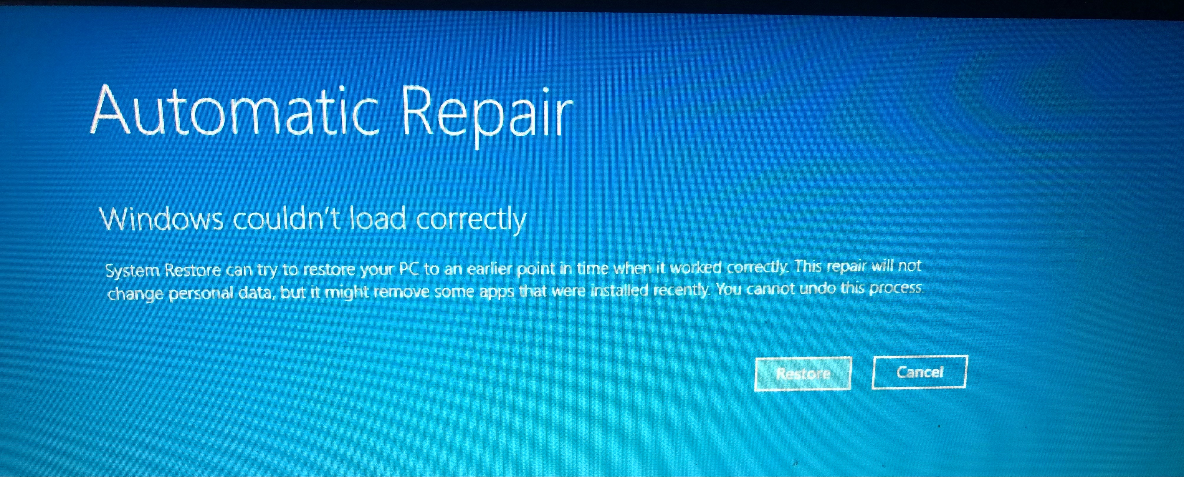

    I booted using the default HDD and then there is a loading it says “Diagnosing your PC” after i let it sit for a while i get this message, should i choose restore? If i did am i gonna lose all of my data?
    2022-04-22T03:11:51+00:00
    I dont see the error message again but after i boot again with my default HDD i got this message, should i just click restore? I kinda aftaid that will wipe all of my data
    2022-04-22T03:15:46+00:00
