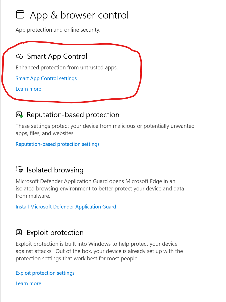

    If you only have 2109 and 2207 then yes, updating to 22H2 will fix the bug, but if you also have 2208 and/or 2209 you are out of luck and updating to 22H2 will not fix the problem, it will just create a new one, where "Smart App Control" is missing from "App and browser control" screen.
    With 22H2 you should see this in the snapshot below, but if you have 2208 and or 2209 updates it will be missing. That is the second bug that was added in 22H2 with the wrong updates. πŸ€£πŸ€·β€β™‚οΈ
