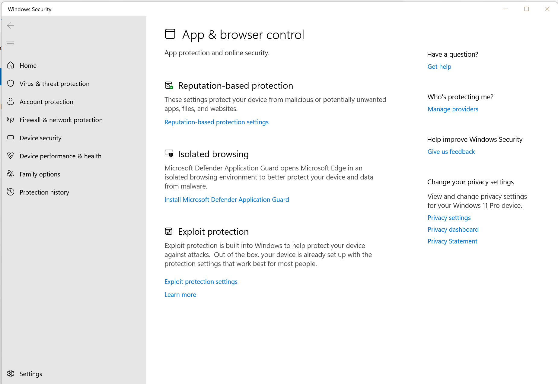

    App & browser control can still be reached from this screen
    the bug is only affecting the security dashboard below where it is now missing completely on 21H2 Builds after they applied the Windows Security
    platform 1.0.2207.20002.
    They fixed 22H2 and broke 21H2 using the same update. 🀣🀣🀣🀣
    Before the latest platform update 21H2 builds were working fine, with version 1.0.2109.27002. πŸ€·β€β™‚οΈ
