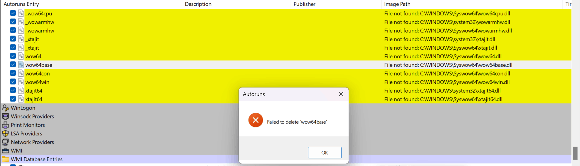

Method 2:
Another alternative is using Autoruns to delete the driver. Download it from here:
https://live.sysinternals.com/autoruns.exe
Run it as administrator.
Go to the Driver tab, locate the driver and delete the same.

    2023-05-03T20:36:43+00:00
    Did that, and received....(wait for it).... nothing back as a response, so apparently there is no problematic file or Windows has confused itself?
