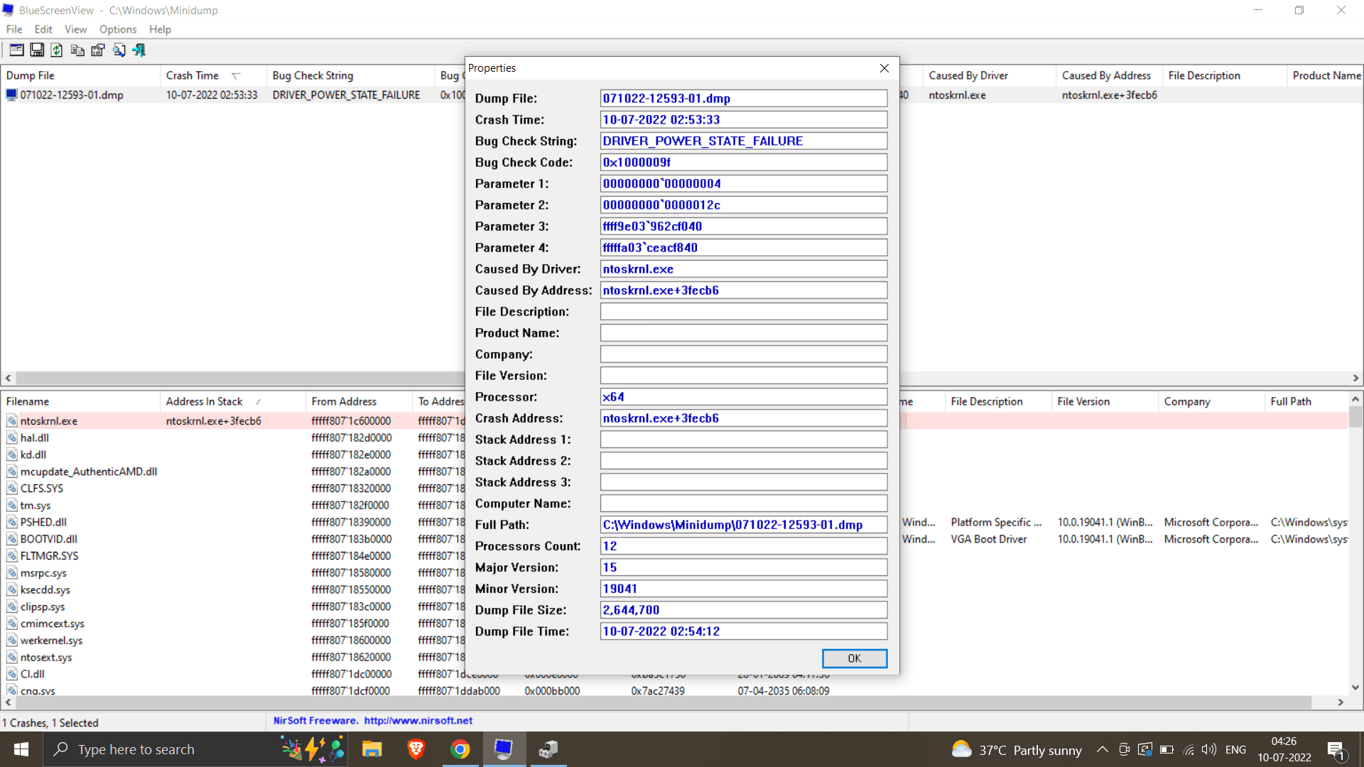

    I tried doing that, but when I uninstall the device, the device completely disappears from the device manager. Is there some way to install the new drivers without selecting that device itself?
    Edit: On further inspection, the device disappears from the network adapters menu into "other devices", and I have installed the downloaded driver now. After the automatic reinstall I mentioned before, the device manager said it was using this one at first, but then after another restart without removing the driver it changed to another version I'd tried which was causing BSODs. Hopefully this will work now.

    No dice. I've given it the same grace period as any other driver I've tried installing, new and old alike, and it's started misbehaving again. It is definitely this driver. Even after I tried uninstalling the device (and selecting the option to delete all driver software on the PC), and then reinstalling that driver manually, the device manager said the driver couldn't be installed because of the code 10 error. I restarted the PC, and it automatically reinstalled that same driver again (I'm pretty sure it's the only driver for that device left on my PC at this point), and it's working again for now. But this is currently looking like exactly the same pattern of behaviour as with other drivers I've tried. It starts off okay and gradually deteriorates over time. From what you've said here I feel like you may be experiencing that same issue and just don't know it yet.
