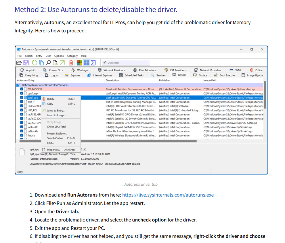

Method 2:
Another alternative is using Autoruns to delete the driver. Download it from here:
https://live.sysinternals.com/autoruns.exe
Run it as administrator.
Go to the Driver tab, locate the driver and delete the same.
