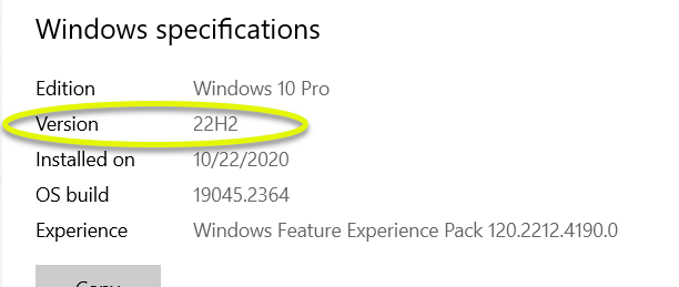

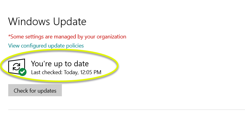

    Finally! Can confirm it worked on my PC as well. Great work info001!
    No thanks at all to Microsoft.
