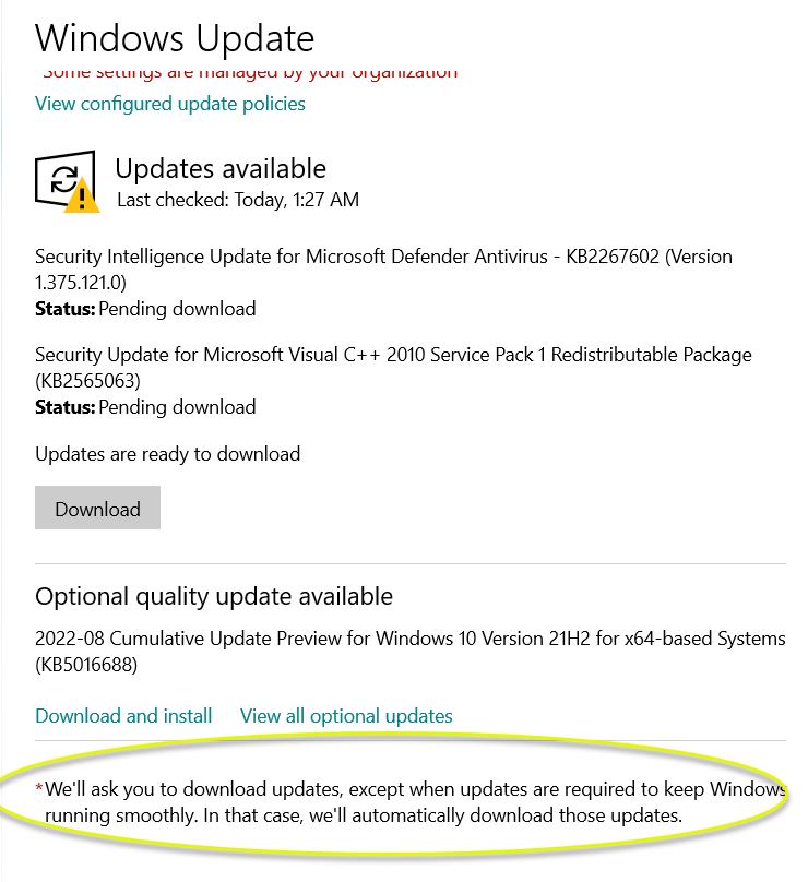

    2022-09-10T20:18:36+00:00
    @OldB0y after changing the group policy Win Update ran, downloaded and installed the update without notification or manual intervention? On the update screen you should see verification you will be notified but it does say some updates will be installed no matter what.
