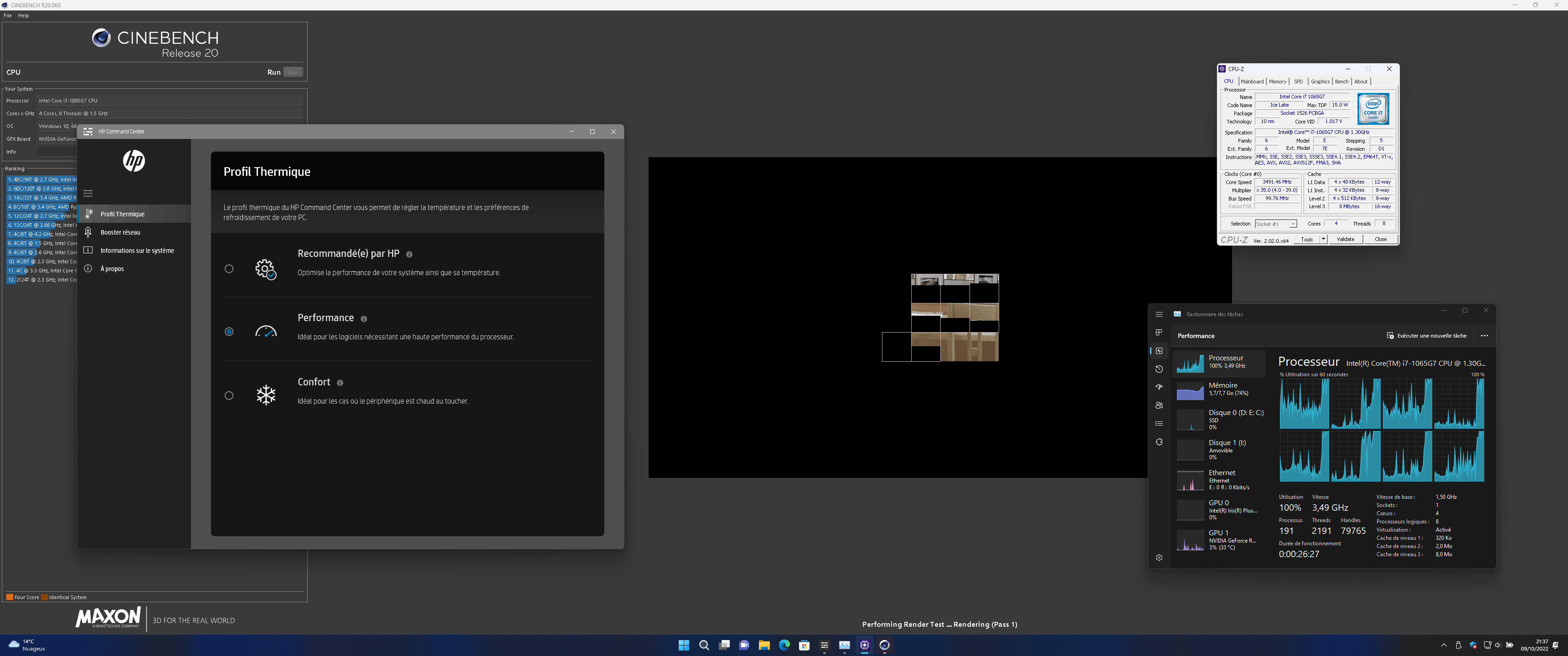

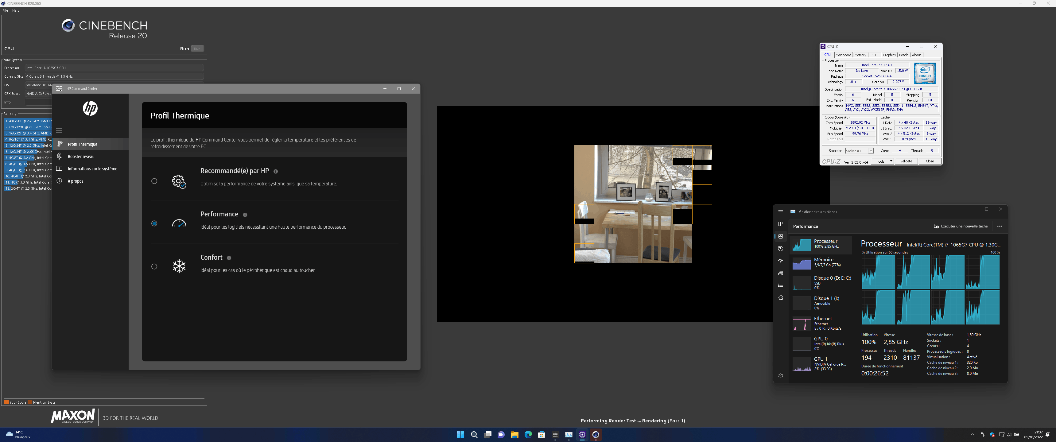

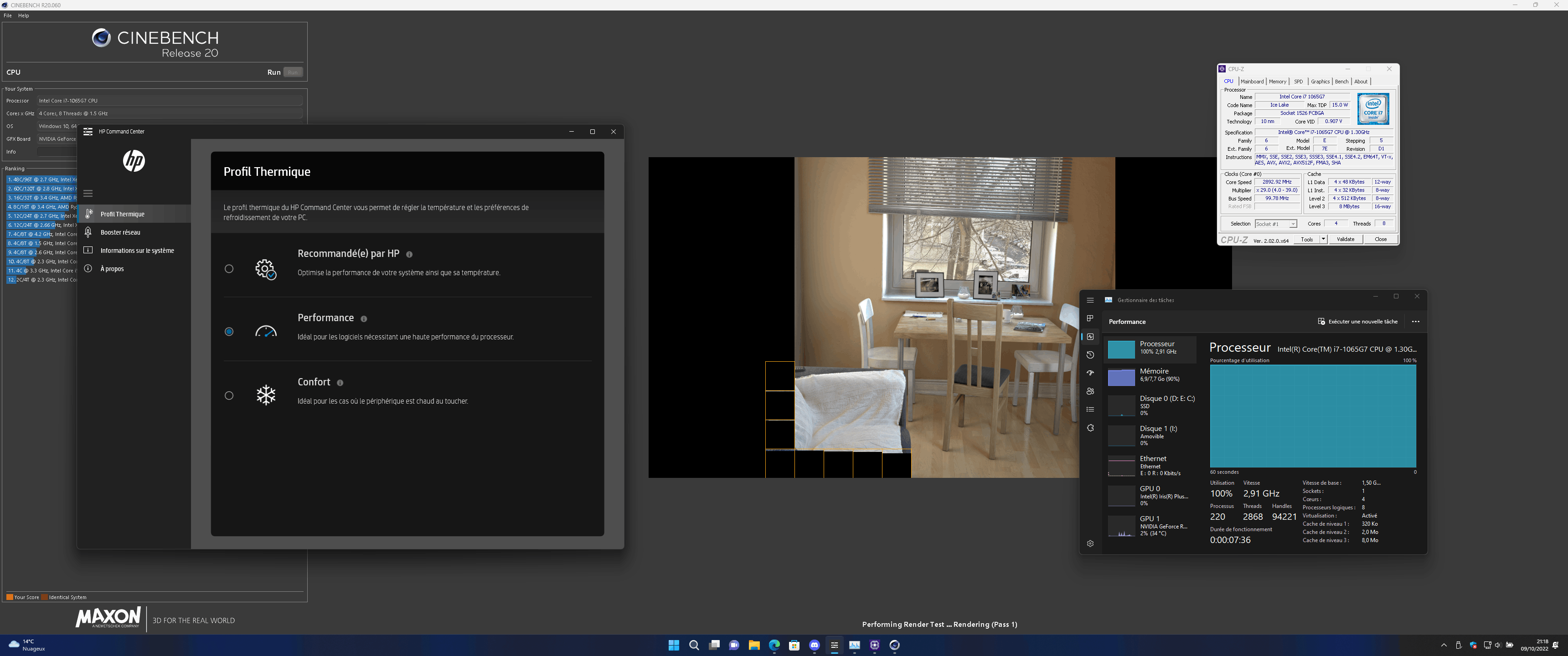

So here is a screenshot of my HP laptop at work: Spectre X360 2020 I7 1065G7
This CPU boosts @ 3.9Ghz one core and 3.5Ghz all cores.
Also set to "gaming" and "performance power mode" in Windows;
At 100% usage the CPU starts rendering @ 3.5Ghz then slowers -0.6Ghz after 5~10 seconds of stress. That is at least what is happening to my CPU... SINCE THE UPDATE!
I allready tried everything I could, the problem doesn't come from a user error.
I took pictures after 2 full reset/reinstalled Windows.. 22H2 two times; It is happening all the time (reproducible)
