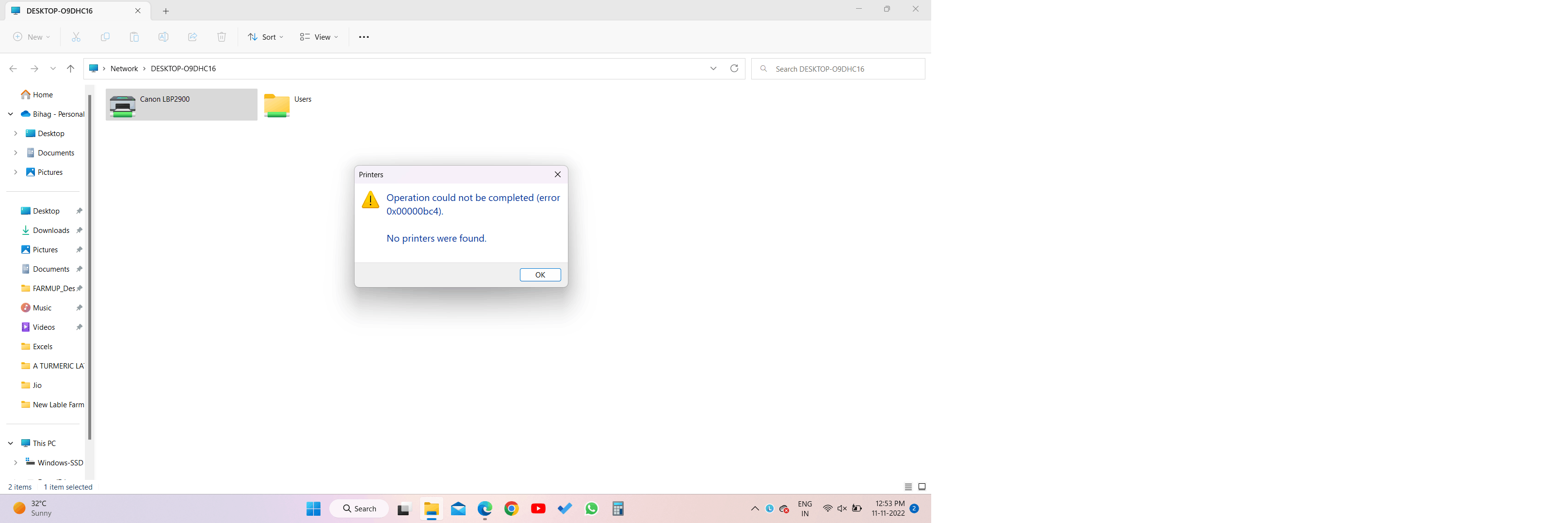

    2022-11-10T12:47:28+00:00
    can i see the error display when connecting to printer sharing
    2022-11-10T13:38:06+00:00
    error showing
