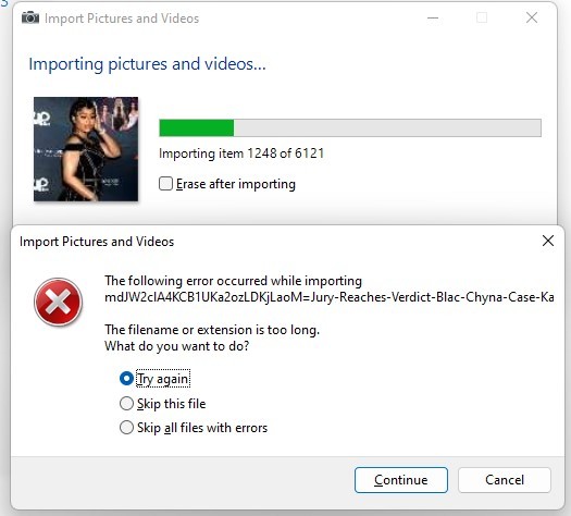

Hello, when I use windows 10 explorer's import pictures and videos on my galaxy s8, the import wizard shows up but they all have the wrong photo which is different from whats showing within android. For some reason, the import pictures and video wizard doesn't detect more than 4k files even thought I have alot more than 4k files. Also, even though the folder to where the pictures/videos are being imported to is empty, windows still shows this error:
how do i fix/reset windows 10 explorer's import pictures and videos ? Thank you

    And I cannot determine the file type of the above file from the dialog box. It's not jpg, and that's why you received the file not found error. Which file type is that?
    That file is jpg I verified it within my galaxy s8 because i know the filename is too long so youll just have to believe my word of mouth.

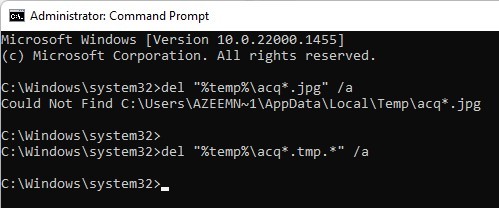

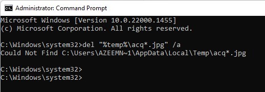

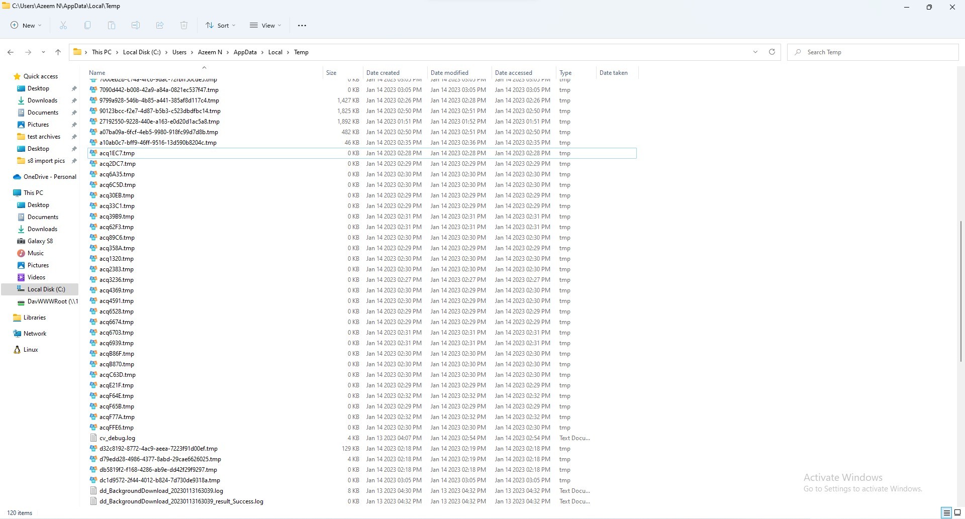

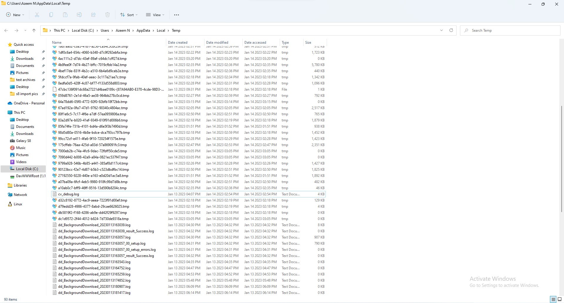

    This time on my galaxy s8 I have selected "This Phone -->Tranferring images" instead of "Transferring files". Alright so the error occurred once again.
    Since the error occured during transfer of a picture I am going to use del "%temp%\acq*.jpg" /a and show you what is shown in my temporary folder.
    As you can see from the above screenshot, all the .tmp files dont have .jpg associated with them. This is reflective of what command prompt shows as well.
    So, the only command that I can use is del "%temp%\acq*.tmp.*" /a
    As you can see the acq temp files have been deleted and is also reflected in the command prompt below.
    I will proceed following your instructions in your last 2 posts -- "And then click "Try again" in the error message window"
